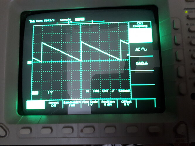

As these signals are repetitive, the use of an analog oscilloscope is enough to picture timings scope but to be able to have correct scope printouts, I have used my old Tektronix TDS360 and you will find a copy in the Zipped file.
On these Scope printouts you will see:
  1. The saw tooth (Fig 1) whose period of 15 msec could be further improved by a few microseconds if I left the LDAC / signal permanently tied to zero volts.
    You will notice that the maximum frequency obtained is 1 /0.015 sec. (or 66 Hz) therefore very far from the announced 25 kHz and my question is quite simple:
What can I modify and how to modify it to reach 5 kHz target ?
  1. Fig 2 shows the timing of CS / versus LDAC /.
  2. Fig 5 being an enlarged view of LDAC / with respect to the rising edge of CS /
  3. Fig 3 shows the timing of CS / in relation to CSK.
  4. Fig 6 highlights the delay between the falling edge of CS / and the rising edge of the first clock in the series of 2 times 8 pulses.
  5. Fig 8 highlights the time between the 2 transfers of 8 bits in the MCP4922 registers.
  6. Fig 7 highlights the time separating the 16th SCK pulse from the rising edge of CS /
  7. As for fig 4 it shows an enlarged shape of clock SCK.

I resumed the test with a a scope picture and you will see that I get a very fast saw tooth
(Period is +-1.2 millisecond but the waveform amplitude is less than .2V in front of the 5V expected.
I guess you must have a idea to improve this situation?

I was a little bit slow to answer you because this morning I was playing with my lawn mower.
I just scoped the last version you offered me and I put the same position on a sheet named "oscillogrammes 22 juillet".
in order to easily compare the scope pictures of the July 20 and 22 versions. (Annexed July 20 sheet named "timing MCP4922_FAST".
You will see that the version of July 20 is still much faster. (The July 20th 'program is included in the directory EXAMPLE of the zipped file posted July 20th. It was using a library that I have modified and which is included too in the zipped file)
I really learned a lot of things, thanks to your help but I conclude it was impossible with the MCP4922 (coupled with an Arduino Uno running 16MHZ) to work at a frequency above 70Hz even using only one of the two units provided in the chip.

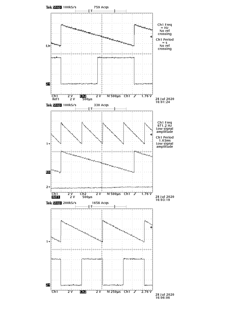

Very surprising and very disappointing experience (until now...) with a 12-bit parallel DAC.
I wired an LTC1450 DAC on a breadboard connected to an Arduino UNO.
I expected to get a sawtooth with a period of less than 2 msec and I have been very surprised to find that its period is> longer than 15 msec!
On the oscillogram you will note the sawtooth and the squared signal arriving on the LTC1450 at pin 15.
The sawtooth period is 7.6x2 = 15.2 msec.
This means that the fastest signal arriving on pin 4 of the DAC is 2048 times faster, i.e. 7.4 usec.
this 7.4 usec signal represents the time of one loop ...
The objective is to be able to significantly improve the speed of this loop!
Is it possible in C++ or may we look for an Assembler issue and how to implement it in C++?
sketch_jul23_lt1450_DAC_rev1.ino (685 Bytes)
LTC1450 waveform.pdf (11.3 KB)
1450 & Arduino UNO.pdf (30.9 KB)
14500lf p1&2.pdf (318 KB)

Please find herewith the sawtooth timing with C++, Both C and Assembler and assembler alone.
You'll note than the signal width with C++ is greater than 3.5 msec and with Assembler this period shut down to a little bit more than 1msec.
I suppose I have reached the limit of a 12 bit DAC wired in parallel mode with an Arduino Uno 16 Mhz clocked.
Thanks for the help received and have a nice day.
