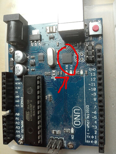

This is my board and I thinks it has 16U2 chip (is that in the red circle?).
How should I reprogram this (I have an Arduino nano in my hands)? If i reprogram the 16U2 chip it will enable again the usb port?
If i use the FTDI cable to program 328P, instead, the usb connection won't works again, right?
Thanks again for your support

It's indeed a 16U2; you can recognise that by the square shape (and the jumpers next to it).
