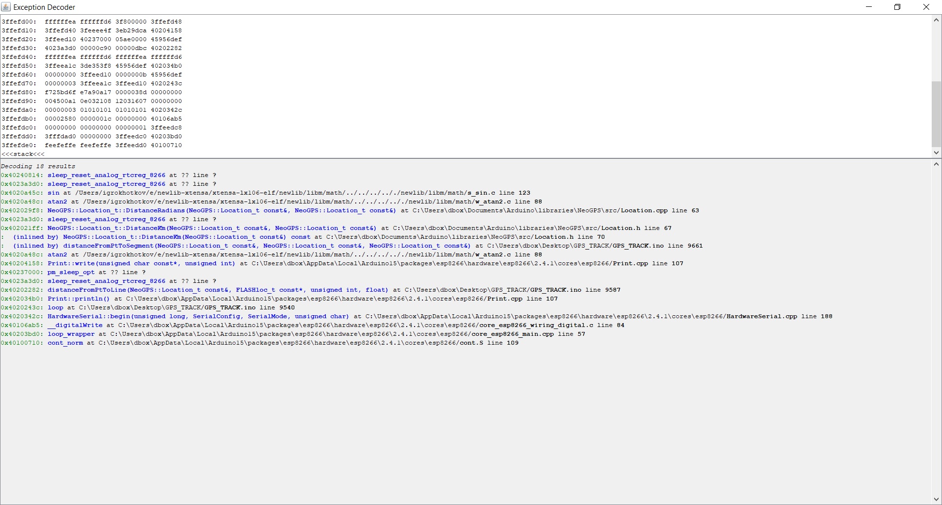

Looking back at the error message, I see this:
    Soft WDT reset
Have you enabled the WatchDog Timer? Is it enabled by default?
If testing a long track takes a long time, you may not reset the WDT quickly enough.
Sorry, I just don't know what kinds of things can go wrong on the ESP family of MCUs.
There is an ESP exception decoder here. It might be able to tell you where the exception happened (if it's not just a WDT reset).
If it's just a WDT reset, it can happen at any part of the sketch.
Image embedded for our convenience:
Technique described here.
And now you can see why we want you to paste the text into your post, in a code block. -_- Just select the text in the window and copy it into your post. The image doesn't have all of the stack contents, just back to the Print::write address. This could be misleading, though... That could be an uninitialized variable inside the distanceFromptToLine routine. It is probably from a previous print call.
After downloading the image and opening it in a separate window, it looks like it was in the sin function when "something" happened.
Because the sin function simply calculates some values from the argument, I suspect that there is some kind of issue with the stack memory. There's no way for a math function to cause an exception like this. The stack does not look very deep, so I doubt that it is a stack overflow.
This trace is different from your previous post, so I assume that it crashes in different places every time.
Sorry, that's all I can tell from the trace. I would research what kinds of issues you might have with lots of FLASH data on the ESP8266, or switch to using SPIFFS.
Could it be some incompatibility of the NeoGPS library with the "D1 Mini PRO 16MB - ESP8266" card I'm using?
Since you only have a problem when there is a lot of FLASH data, it is probably not a NeoGPS problem.
