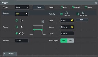

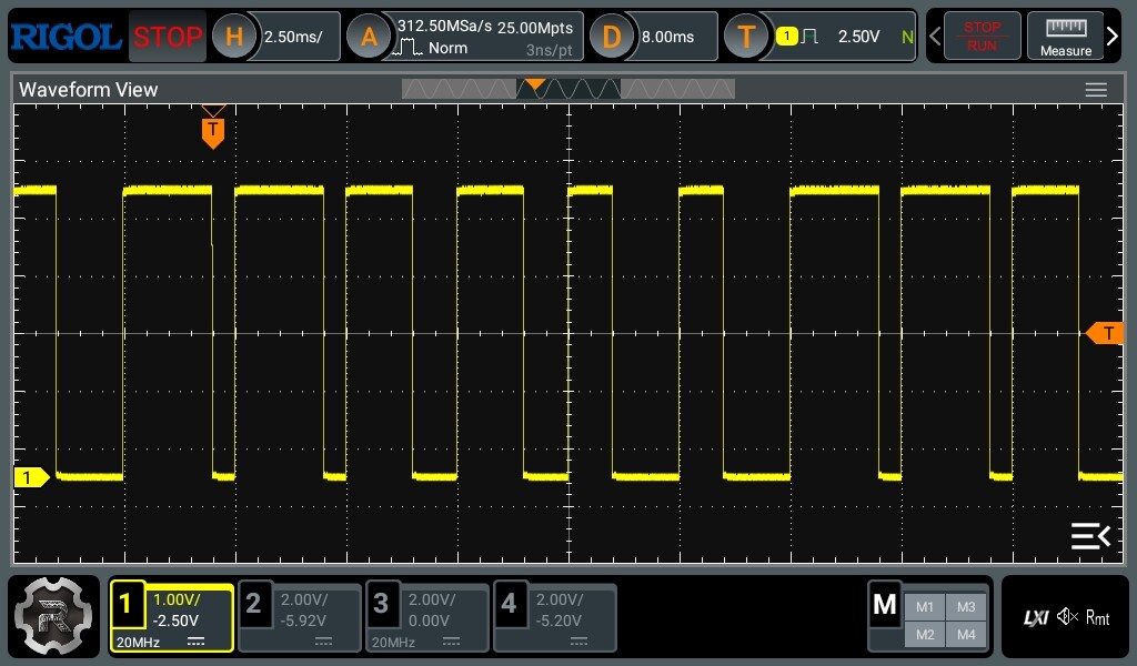

I already checked the code and ran a scope through the pin 9, the expected output if the array of pwm commands are {900, 1100, 1300} than a 400 hz pulse train at an update rate of 200 hz (its actually 250 but for the example i am choosing even numbers) would look something like this 900, 900, 1100, 1100, 1300, 1300. But the scope shows absolutely random sequence
It doesn't if you get the oscilloscope to trigger correctly.
Shows a sequence of 2 x 2ms pulses, 2 x 1.5ms pulses, 2 x 1.0ms pulses, repeated.
I triggered the oscilloscope on a positive going pulse, >1.8ms wide and < 2.2ms wide.

But you're triggering in this sequence from what I see in the screenshot
1000, 1000, 2000, 2000, 1500, 1500
But according to the stored array, shouldn't it be,
1000, 1000, 1500, 1500, 2000, 2000
