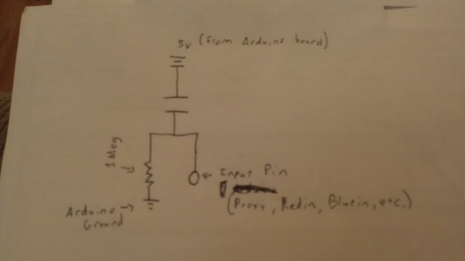

all of the in pins including the proxy are connected to a relay which is switching them between ground and 5 V the problem is that the board tends to produce random results regardless of the situation. I tested it on two different boards to i have to wonder if the problem is code based
also when i connect proxy high and also connect one of the inputs high the alarm continues to sound and the outputs for that color stay low
I'm not recognising the way you use terms like proxy.
Perhaps it would be best if you describe the bahaviour you want to achieve in terms of the Arduino's inputs and outputs, and then explain how the current behaviour differs from that.
ok proxy and redin, bluein, etc are just the names i have given the pins to remind me what i have put in there.
proxy is connected to a relay which gives out 5v or ground based on the readings of a proximity sensor
all outputs should be low if the proxy is zero
once proxy goes high, the alarm should sound, unless one of the other inputs (redin, bluein, greenin, yellowin) is high
if one of those are high then the corresponding output to that input should go high and light the led attached to it.
the problem is that regardless of proxy's state the alarm goes off. sometimes it appears to function in that when proxy is low the alarm doesn't come on, however as soon as proxy goes high, the alarm goes off regardless of whether or not one of the other inputs is high and then even grounding the proxy again will not shut off the alarm
The sketch seems to say what you want it to say. I suspect that your wiring is the problem.
Exactly how are your relays connected to your inputs?
here is a basic hand drawn schematic.... sorry about the poor drawing ability
1M is too week for a pull-down resistor, particularly on an analog input. Change it to 10k.
In the bottom diagram, what is that thing between the relay contacts and the LED?
so a 10 k will work better than a 1 megaohm? oh that thing in between there is a buzzer..... i use it to make an audible alarm
