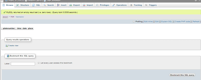

Thank you for response. What I actually need is send the data to a localhost. The picture attached is where the data will go.
localhost means that the client and server are running on the SAME machine.
Good luck getting MySQL to install on your Arduino.
Good luck building PHP for your Arduino.
