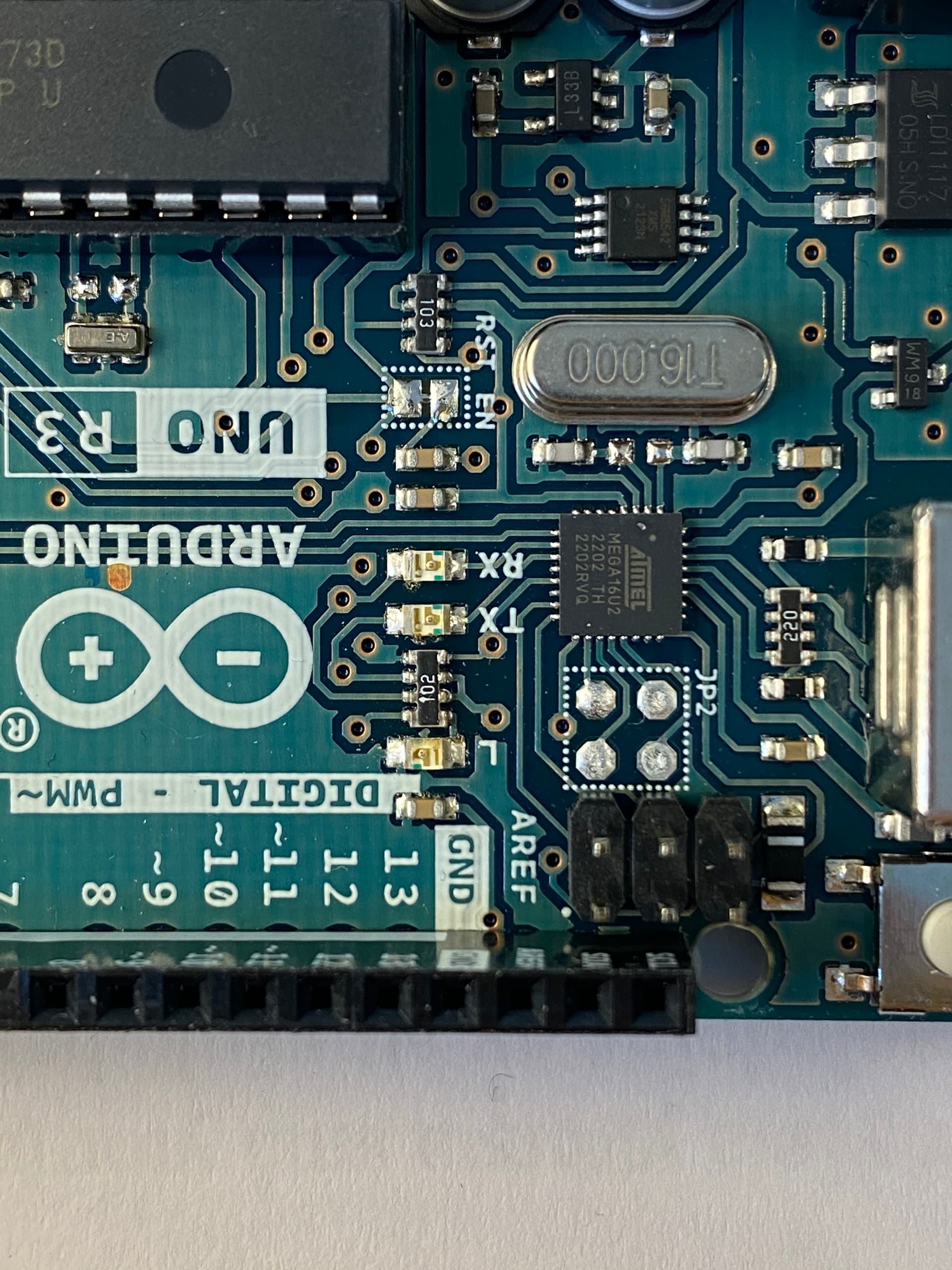

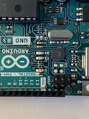

Send some pictures of the Arduino, around the spot where the onboard LED is.
Please photograph both sides of the board.

Here are pictures:
The back of the board is different from the R3 I have. Mine has an all white back. There looks like there is no physical damage or bad soldering, but not very many faulty components show up as physical damaged, unless they have suffered a great deal of abuse.
Can you put in a slow blink program on pin 13, and measure that the voltage on the pin changes. The look at the voltage across the LED, if it is not changing then it could be a short circuit LED or a blown driver buffer, that is the very small surface mount chip next to the LED.
Remove all power and then try an measure the resistance of the LED with the leads of your meter first one way and then the other. The actual measurement is not important, but with the leads one way round you should see a pin prick of light and that indicates the LED is working.
