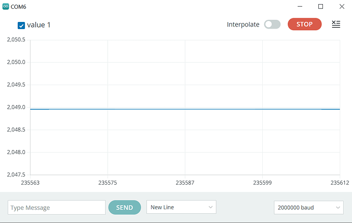

I've been playing around with the minima and here are a few impressions
I've been pleasantly surprised with the accuracy of the ADC
Here is a measurement from my precision reference (which is 2.048V). With a little oversampling and filtering it's rock solid and quite accurate(ideally would read 2048)

Hi, lovely graph!
Is this with USB power or with an external input that gets the internal board DC/DC ?
On my R4 board I get the nominal +5V at something like +4.72V when VUSB powered (due to D3 the Schottky reverse protection diode for when the internal DC/DC is running).
If I attach external power the ADC reading changes and gets a lot more noisy.

USB, still get a bit of noise at 50Hz but I've used a 4th-order digital filter with a 5Hz cutoff so even this gets removed for very clean DC signals.
that's a pain. I haven't powered externally yet

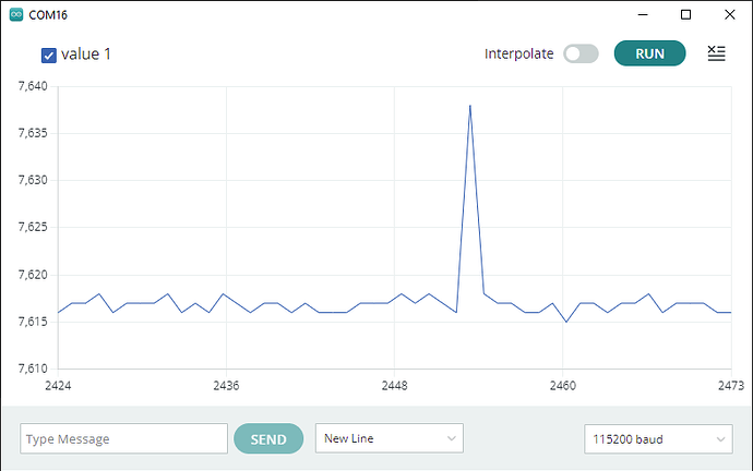

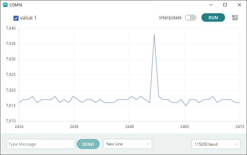

R4 ADC Tests: Note these are "raw" readings without any averaging or other filtering.
14bit ADC, with USB power:
14bit ADC, with external power i.e. DC/DC converter running:
Just on my workbench, not a "tidy" measurement.
