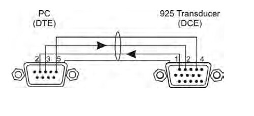

The transducer has a D-sub15 connection, I made a cable for it so it has an D-sub9 end, the diagram looks like this (the cable looks terrible! But it works): |500x229
I have tested that the cable works by using an RS232 to USB cable, and using a serial terminal and sending the command to the transducer, and effectively receiving the ambient pressure (the command is: @253PR3?;FF).
However having the transducer connected to my computer is not efficient, so I want an Arduino to keep sending the string @253PR3?;FF while having the result in an LCD. As of now, I am just trying to have the Arduino send @253PR3?;FF through the TX pin and receiving data through the RX pin, then printing it in the serial monitor, obviously the TX, RX, VCC (5 or 3.3 V) and GND pins of the Arduino are connected to the max3232 converter.

One cannot have more than one deice connected to a serial port. As it is your sketch has both the transducer and serial monitor connected to hardware serial. I would suggest that you set up a software serial port for the transducer and use the hardware serial port (pins 0 ans 1) for program output and upload. There is the Software serial library that comes with the IDE and a couple others that are "better" (NeoSWSerial and AltSoftSerial).
Here is your sketch with an added software serial port to illustrate how it would work. One suggestion. Don’t use the String class and readString(). The String class can cause memory fragmentation if not used carefully and readString() is a blocking function which can make the sketch less responsive. Robin2’s serial input basics thread shows how to do serial in a robust and non blocking manner and uses null terminated character arrays (strings [small s]).
