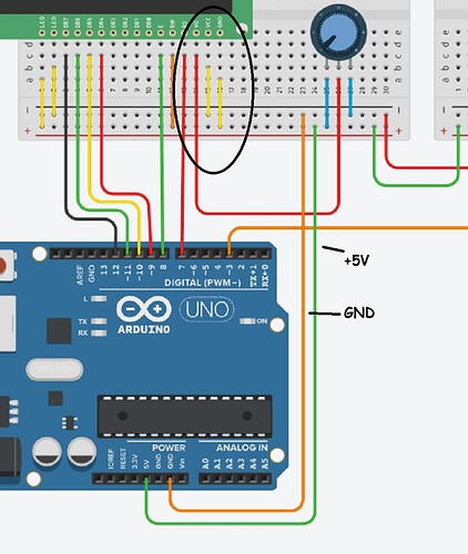

Arduino Uno shuts down after 5 seconds
I have adjusted that so that it is over the center part (I had to get another breadboard). The problem still persists though.
(I cant send more posts for 22 hours since I am new) What does diagonally opposite pins mean?
Disconnect the two wires (yellow) that go to the two LED terminals.
Do you have a DMM?
I see that you chose to ignore the advice to use diagonally opposite pins of the pushbutton
Check the 5V and Gnd wiring from the UNO the LCD.
Not a choice, it would appear!
It means either top-left and bottom-right, or bottom-left and top-right pins.
Diagonal Button Wiring
Everything seems to be working now, thankyou for your help and support!
