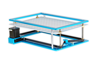

I have a Leadshine DM422 stepper motor driver controller purchased from lightobject.com for a Z table adjustable laser bed for a K40 laser cutter engraver. The bed uses a single 42HS03 2A 2 phase 4 wire stepper motor and the DM422 is listed on the website as one that works with this motor. I am powering the controller with a 12v 2.5A power supply.
I am trying to control the stepper controller using an arduino uno and i think i have it wired correctly but no commands i send to the controller seem to do anything.

Z table:
Driver:
http://www.lightobject.com/Leadshine-mini-2-Phase-DM422-22A-1-axis-Stepping-Motor-Driver-P1024.aspx
