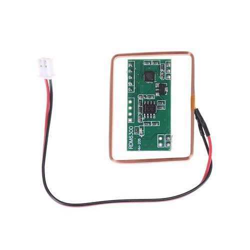

HI. Would like to know if arduino uno can take load of the following devices to start my project
https://robokits.co.in/motors/dc-motor/12v-high-torque-motor/high-torque-dc-geared-motor/high-torque-12v-dc-geared-motor-100rpm
