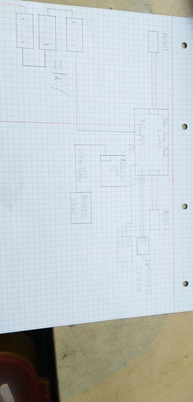

I will post my circuit diagram but I have the pwr jumper removed because I am powering the shield with 11V and the Arduino uno through the USB. I have two different power supplies.
Here it goes. As for the code , no matter Wich code I upload it doesn't move... Even with just a code to make the motors move forward.
Like i said before the Arduino uno is under the shield.
