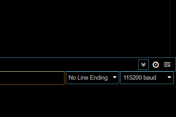

Hi, @ALIEN93Hendrix
When you open the IDE monitor you should have this on the right hand side.
Select the baud rate that is the same as in your code.
