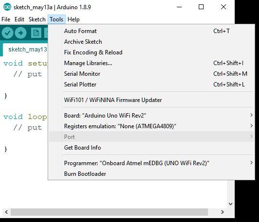

I installed the Arduino WiFi Rev2 board and selected it. I installed The arduino mega avr board package.
The board still does not show up as a COM device. It shows up in Win 10 device manager as "PORT USB Serial Device""
I am using Windows 10 and Arduino 1.8.9
What else needs to happen to make it recognizable as a Com device?

I want to be certain we are talking about the same thing here. In the attached photos, you can see the device manager advanced settings on the board does show a com port, but in the second image, you can see that the Arduino IDE does not see a com port. That is the port I am talking about when I say there is no available com port assigned to the board.
And yes, I have since rebooted the PC.
