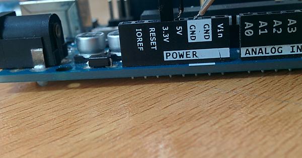

Thank you for your responses. One small correction regarding the size of the sd card. It's a 16 gb card on which I've created a 2gb partition.
Here are the pictures of the module, the arduino's digital pins in use and a picture depicting 5v and 3.3v supply to sd card module going from arduino.
And I'm not sure about the level shifters/converts. Can you find that out by looking at the pictures?

That type of module, (identical to mine), doesn't have on-board level shifters, so you need to use external ones.
Also, don't connect 3.3V to the module's 3.3V pin. The SD card module has an onboard 3.3V regulator, and you're connecting 3.3V to it's output. Not a good thing.

I've used a CD4050BE on MOSI SCK and CS pins and it has worked like a charm. You're a life saver.
Thank you very much! :slight_smile:
