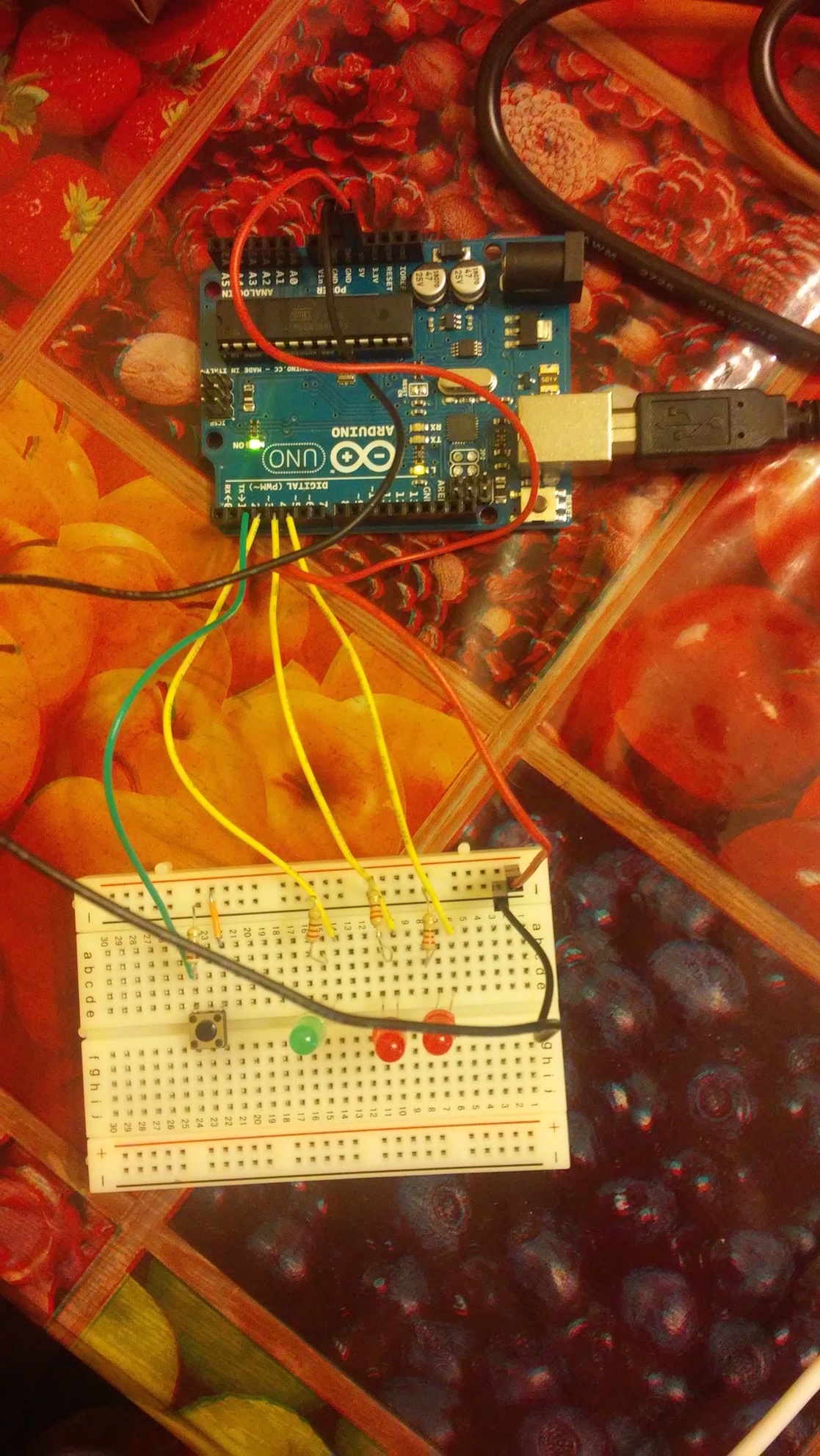

I've been trying during all day to make my Arduino board works.
I'm trying to run the SpaceshipInterface sketch. It uploads to the board, but nothing happens afterwards.
I tried the blink project and it is ok. The L, RX and TX are also ok. Every time I upload the sketch, the L led on the board blinks three times, very fast. I read here on the forum that this is the expected behavior.
I reviewed the project a hundred times and the IDE shows no error messaging. Just tells that the uploading is done and everything else is fine.

I tried upload straight from the examples folder. It didn't work. I attached a picture of the arduino and the breadboard. I think I followed correctly all the information in the book.

Sorry, here follows the attachment.

That example looks like it wont do anything until the button is pressed, so maybe there is a problem with the button?
So is the button connected in the correct orientation?
might the led's be orientated backwards? try flipping one or two of them just in case(if it does nothing then you probably have them right :smiley: ,go ahead and flip them back)
Note: When viewing an led from the side, the larger piece of metal gets connected to ground(I didn't know if the example goes over that).
I cant help but notice that the built in led on pin 13 is lit up yet nothing in the arduino example calls for that pin, this makes me wonder if something in specifically your code is awry.

I can't tell for sure with the other two, but the LED on the right is definitely connected backwards. Spin it around and double-check that the other two are correct. The flat side of a LED is the cathode, (negative).

I did the changes. Everything is ok now!
