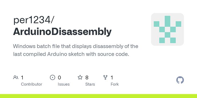

As I had mentioned in the linked issue, I like to use the -S option with avr-objdump to get intermixed source code. I find this makes it much easier for me to figure things out. This functionality had been broken at the time I wrote that issue but is now working again with the current version of Arduino AVR Boards. An example of the disassembly command I use:
avr-objdump -d -S -j .text C:\Users\per\AppData\Local\Temp\arduino_build_84577\Blink.ino.elf > disassembly.txt
Note that you need to save the sketch before compiling if it's modified in order to get intermixed source code because modified sketches are saved to a temporary sketch folder before the compilation and then deleted immediately after.
I wrote a batch file that finds the .elf file in the most recently created temporary build folder and does the disassembly on it so I can just compile and then run the batch file to get disassembly.
Add a "-C" option to the objdump command to get it to un-mangle C++ names.

Here's my batch file just in case snestrup2000 happens to be using Windows and might find it useful:
I didn't mention it earlier because it had been broken by Arduino changing the build folder naming scheme in recent IDE versions but I have that fixed now.
