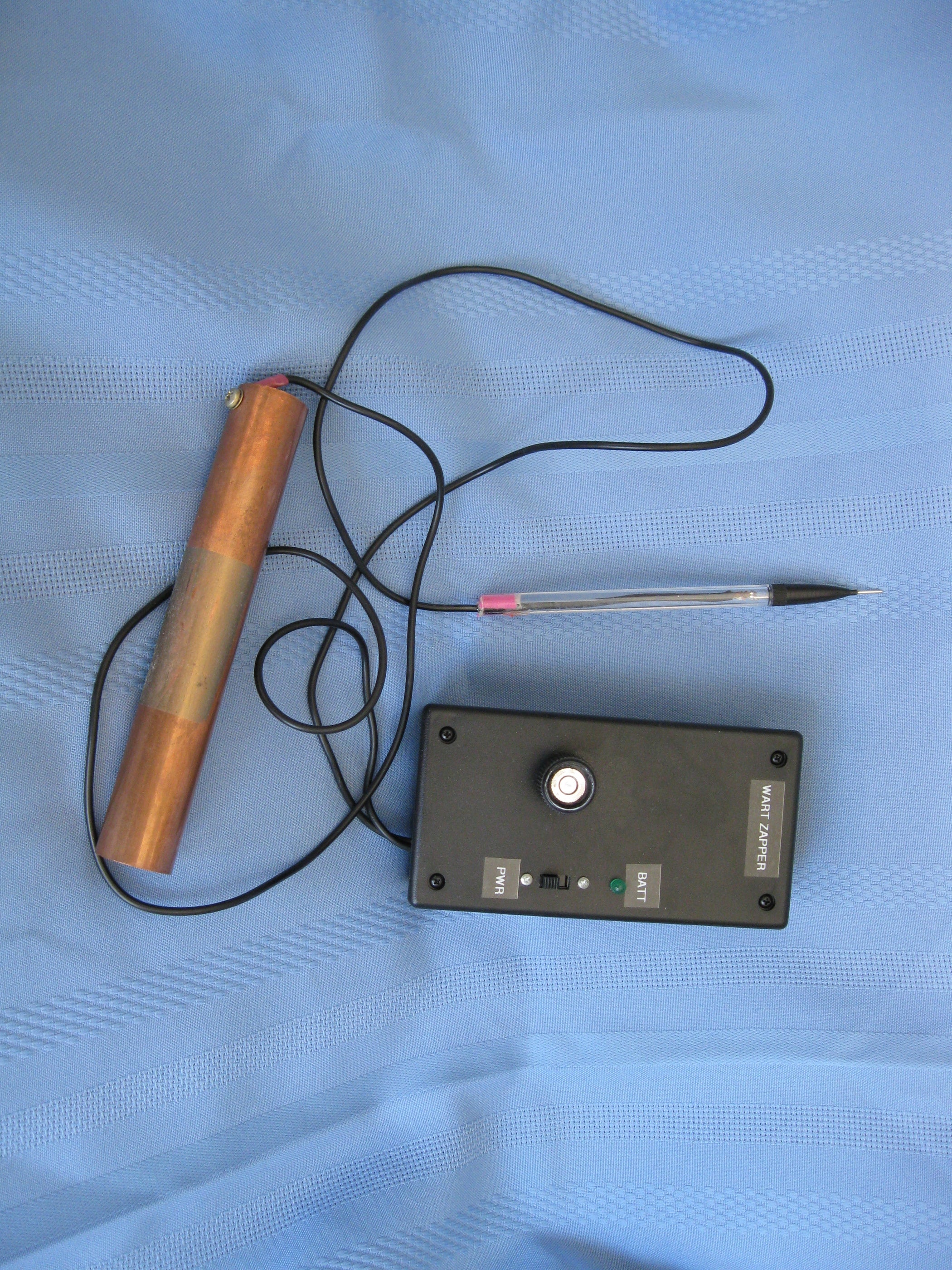

Thanks for your replies guys! It looks like someone has already built it with 555 timers..
http://www.zen22142.zen.co.uk/Circuits/Misc/wart_zap/wart_zapper.htm
and
They use 9 volt batteries and a voltage tripler. I'd rather use Arduinos to be able to adjust the frequency more precisely.. :slight_smile:

a simple NE555 with the correct components; Polyester caps and .1% mf resistors is capable of better frequency stability than the Arduino is... I was getting .05% accuracy in the mid 80's with that part easily and that is at least an order of magnitude better than needed... 1% is real easy. The other thought is why oh why is it necessary to use a $15.00 part when a $0.05 part does it as well??? are you intending to enter the field of patent medicine or do you have a wart you don't/can't show to a doctor?

So does anyone have code I could work with to pulse at 2.27 khz? I figured to get to 2.27KHZ, the cycle should last 47 microsecs. so 23.51 micro secs turned on, and 23.51 turned off?
The period 21kHz is 47usec: maybe brief positive-going pulses, maybe negative-going pulses, maybe they should be Gaussian - 1/2 on & 1/2 off.
Naaah, use 0 - 100% PWM and tune for max smoke...
