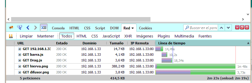

Hi all,
i run into a problem trying to setup a web server with SD card. Te problem is speed. I read already a lot of related posts and i know that Arduino is not a fastest thing out there for this porpuse. But I think that in my case is a bit more slow than it "should be". I tested it in Firebug and what I see is that it downloads data with stops and also it takes sometimes long client waiting time. I am using Mega and a wifi shield with 10 rated SD card. Here is the server part of the code which I am using (I just found it somewhere on the web). If someone could give me some insight on what is going wrong it would be grate. Thankyou in advance.

while(webFile.available()) {
num_bytes_read = webFile.read(byte_buffer, 64);
client.write(byte_buffer, num_bytes_read);
This is why it is painfully slow. you are printing each bit as it is read from the sd card. This is essentially the same thing as using client.print(F("stuff to print")); where it prints one bit at a time. I found the arduino mega didn't have enough SRAM to not use (F( but using (F( was to slow, so I hacked the crap out it to make it so that it worked the way I needed so I could use (F( while at the same time not loosing time to do it.
What you want to do, is create a buffer and when the buffer is full, it client prints all the chars in the buffer at once, then clears the buffer.

@Thomas499: He is using a 64 byte buffer. This reads up to 64 bytes and returns the number read. Then it sends that many bytes over the client connection.
but does it wait until the 64 byte buffer is full, or does it client print something each time a new char is found?
If your code requests 64 bytes, and the SD card has 64 or more bytes remaining in the file, it sends 64 bytes. Only the last packet may contain less than 64 bytes.
