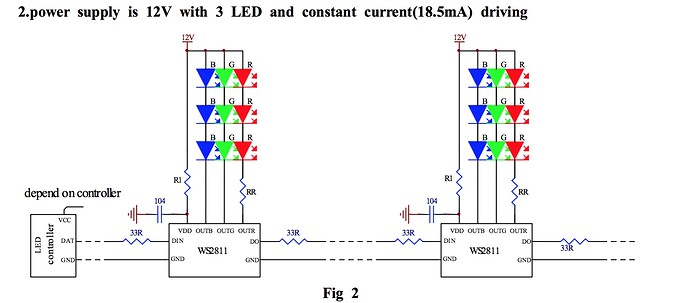

I have two separate strips of WS2811 LEDs. Both are 3 LEDs/IC and are 60 LEDs/m. Using the following diagram I am able to successfully illuminate and execute code via my FastLED library.
However, when I attempt to connect strip #2 independently of strip #1(which works) using the same configuration nothing happens. It doesn't even light up to all white. If I eliminate the arduino and run +12V from the battery directly to the LED strip and then use my Data wire as a ground it will light up 3 LEDs in Blue. Any ideas what is going on?

I apologize for not being clear in the initial post. I have included a photo of the two WS2811 strips. In addition a new diagram.
I wanted to make sure the lights in fact illuminate and turn on as they should so I attempted to connect the LED strip directly to the battery source. In diagram #1 using strip #1 all LEDs illuminate to 'Bright White' which is what I anticipated.
In diagram #1 using strip #2 I get nothing at all, all LEDs stay off. I figured the strand of LEDs was no good so I used the setup from diagram #2 for strip #2 and get 3 LEDs to illuminate to Blue.
Now looking at the photo of the actual LED strips you can see strip #2 has DI to DI connection. Maybe this was a manufacturing problem and there's just a defect with the strip?
Why show the diagram of what works, instead of the the diagram of what you actually need help with?
You need to better explain what it is you tried, what you have, and because I have no idea what "use my Data wire as a ground" could possibly sensibly mean.
Are both strips identical in every way?
ATL_Arudino:
If you mean 5v, carry on. If you mean 12v, WS2812B run on 5v....
DrAzzy:
Yes but he has a WS2811 strip and some of them are configured for running off 12V. To do this they have three LEDs in series.
