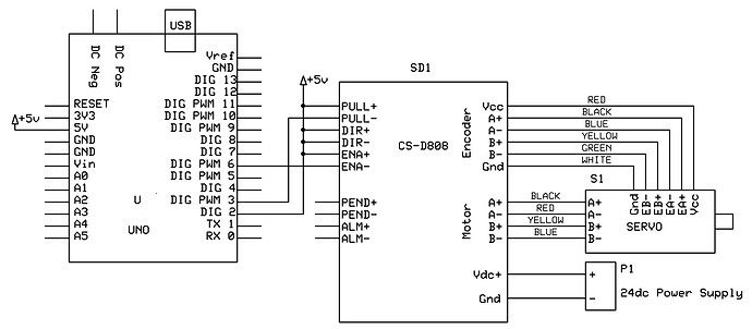

Hello everyone. I bought NEMA34 nad CS-D808 driver (30V-80V) . I asked him can I run this with 24V and he says yes but now it isn't working. Is it to code or is it because vol is not enough? Here is my code

My connections is like this:

Only if you are lucky. Ther driver gives a minimum of 30V. If it works there is no guarantee it will keep operating or how long it will last. A complete schematic showing all connections wouold be a big help. I could not follow your power and ground interface.
It's because you are trying to go from zero speed to 5000 steps per second (1500 RPM) instantly.
Try a sane speed of 100 RPM and 3000 micros per step. How about the enable pin?

Do you have a DMM?
Can you see the 3second ON and 3second OFF pulses on the step pin of the driver?
Can you post a wider picture of your project so we can see you complete component layout?
Looks like the drive is enabled by default so the wire to pin 6 should not be needed so remove it for now. Looks like default is 400 steps per rev, I changed 3000 to 1500 so 3000 micros per step or 333.33 steps per second, 50 RPM. Post a drawing of which drive terminal is connected to which motor wire and which Arduino pin.
I did. I saw constant 2.7V . I connected 1 prop to PUL- and the other prop to GND.
Here is my connections.
I send a picture of my design too. In that design Encoder and signal pins are not connected. I tried with with 800,1600,3200,6400,12800 pulse.
I found the problem. I didn't connected Encoders cable but Closed Loop motors encoders pins should be connected. I connected encoder cables and it is working now. Thank you everyone.

How about you now post a proper circuit diagram so we can see what your connections are now?
Where is your stepper in the images you supplied?
Please a picture of the stepper.
Hi, here is a photo of encoder. I found Chinese forum like this connection. I shared photo, as you can see Encoder side is not connected anything. I connected that Encoder signals like this image. My connections are same. I added this connections only. As I know, my stepper is closed loop stepper so I need to connect these signals to this

That is full blown servo motor, mis-titled "stepper".
PS. I hope a full blown schematic of your project is to follow?
Which program should I use to share my connections? I am just driving motor . Not too much :slight_smile:
Pen(cil) and paper.
Here is a final connections of mine. It is working.
Okay good that it is working.
This I believe is your schematic;
Yes, that is mine schematic.
