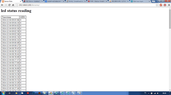

Hi,ı want to push data a mssql server using arduino and php codes.So firstly i tried send data a mysql server with xampp.My codes and php files given below;

This codes sending data my server in every 32 sec.But arduino serial monitor gives some error about php codes.

ıf you share your thoughts ı wil be glad.also ı attach my server web page data pic.
The Arduino code is not. The Arduino code makes ONE call to the server, in setup(). It never calls the server again.
$Leddurum=$_GET["Leddurum"];
The GET request does NOT include any variables. So, this statement is looking for the value of a variable that is NOT part of the GET collection.
