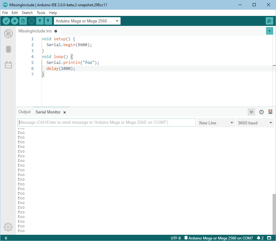

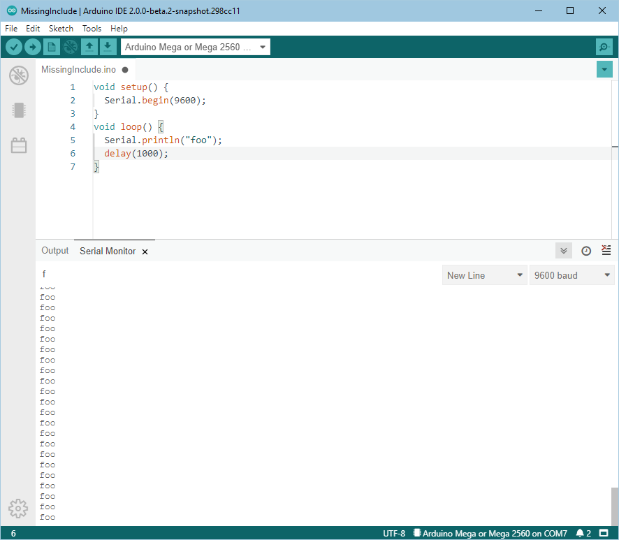

🐛 The keyboard control for sending data from Serial Monit… or was changed from <kbd>Enter</kbd> in the classic Arduino IDE to the unintuitive and less convenient <kbd>Ctrl</kbd>+<kbd>Enter</kbd> in Arduino IDE 2.x
The first time I tried to send data via Serial Monitor, I jumped straight to typing into the input field without bothering to look at the gray text, then spent some time repeatedly pressing "Enter" without any result and hunting around for that "Send" button.
## To Reproduce
1. Connect any Arduino board that presents a serial port to your computer.
1. Select **Tools > Serial Monito** from the Arduino IDE menus.
1. Type some text in the Serial Monitor input field.
1. Press <kbd>Enter</kbd>.
🐛 Nothing happens.
## Expected behavior
Pressing the <kbd>Enter</kbd> key while the Serial Monitor input field is selected causes the data to be sent if any is present.
## Screenshots

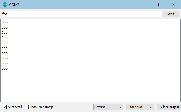

In the Java IDE's Serial Monitor, sending data is done by typing into the input field and then either pressing "Enter" or clicking the "Send" button:
In Arduino IDE 2.x, there is a message that explains the unintuitive <kbd>Ctrl</kbd>+<kbd>Enter</kbd> system to the user:
but that message disappears as soon as you start typing (as it must). The user will expect the field to work in an intuitive manner and not bother to read the text, then once the find it is not working as expected, the text won't be there to guide them:
