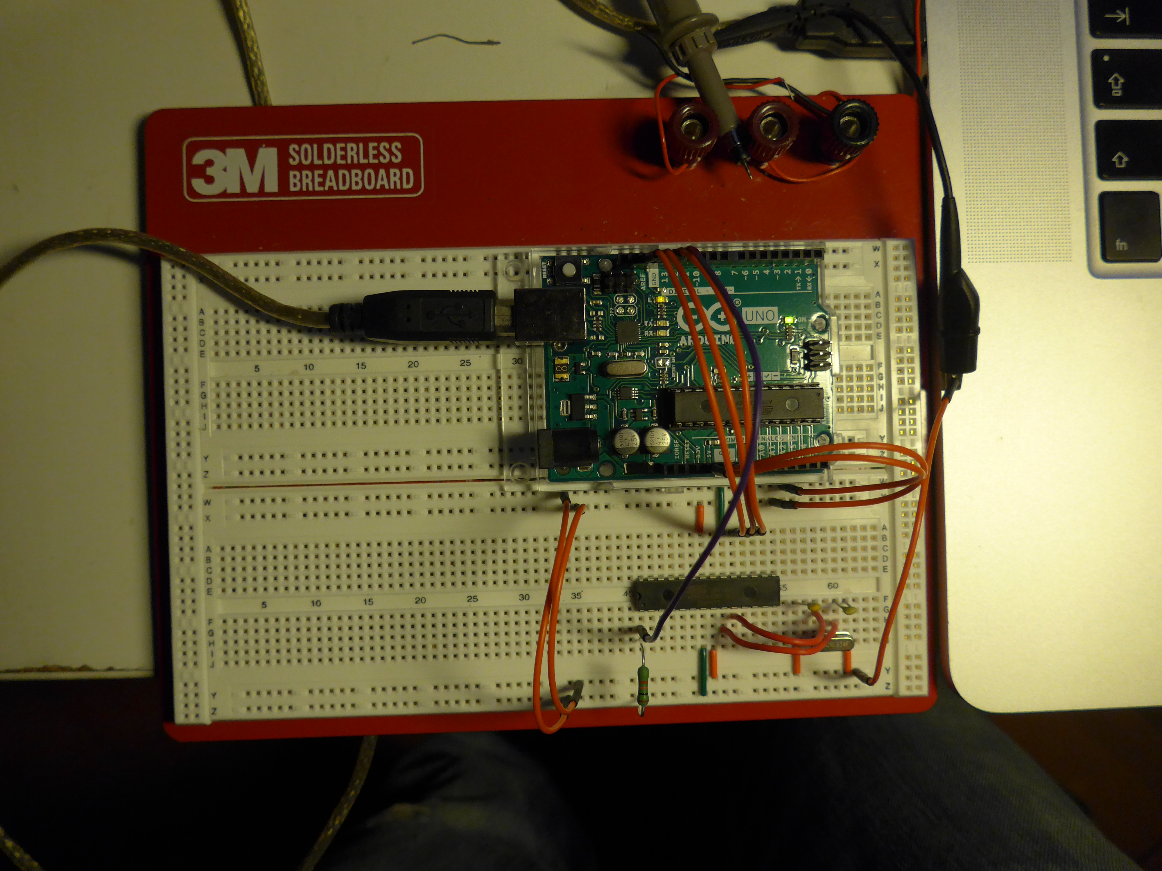

I am trying to burn a bootloader on a fresh ATMEGA328P following the description at
I use a Macbook Pro 2015 (so USB3...), High Sierra with Arduino App Version 1.8.13
I can upload the ArduinoISP sketch
I wired the Arduino with the breadboard according to
The result looks like this:
To my opinion there is no mistake (don't get fooled by the perspective - the wires from AREF, GND and 13 go to the right pins: 17,18,19). Unfortunately my scope is not fast enough for the CPU clock, so I can't check this - I only see that some kind of clocksignal exists.
Now the description says "Select "Arduino Duemilanove or Nano w/ ATmega328" from the Tools > Board menu."
But unfortunately I do not have this setting in the menus:
You see there is either "Arduino Duemilanove or Diecimila" or "Arduino Nano" - but nothing like "Arduino Duemilanove or Nano w/ ATmega328".
No matter with which board setting I try to burn the bootloader I get the error:
avrdude: Yikes!  Invalid device signature.
         Double check connections and try again, or use -F to override
         this check.
Error while burning bootloader.
What is wrong here?
Is the description outdated? The document footer reads "Last revision February 05, 2018, at 08:43 PM"
Any help is appreciated.
With kind regards
Florian

The embedded image doesn't appear for me. I can see it on your website:
It looks like it's a very large image. I would recommend resizing the images and then attaching them to a forum post. If you click the "Reply" button, you will see an "Attachments and other settings" link that will allow you to make the attachment. The image should then automatically be embedded into your forum post, but if you want to embed it at a specific place in the post, you can follow these instructions:
http://forum.arduino.cc/index.php?topic=364156.0
fanwander:
Yeah, they are outdated. Select either Tools > Board > Arduino AVR Boards > Arduino Duemilanove or Diecimila or Tools > Board > Arduino AVR Boards > Arduino Nano

Hello,
I meanwhile solved my problem using a second Arduino Uno to hold my target Atmels.
I can not tell what the problem was. Sorry about this.
And as summary for my original question: yes the description is outdated (status oct. 2020). See the entry of @pert
Regards
Florian
