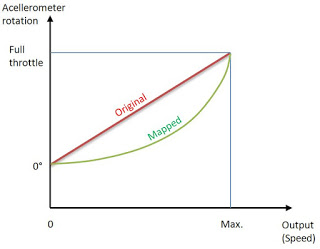

We actually need the 0,8V-3,5V output from the arduino controlled by the potetiometer
because we want to modify some concepts in the code because right now the bike use this voltage 0,8V-3,5V
and the accelartion is dangerous in some points. That's the problem.
Let's say that also a 0,8V-3,5V input in the arduino tha will be consider in the code it will give another ouptut
in the same range .
check the image to see what he is trying to accomplish!
In the code of the link that you provided, you'll need to change the voltOutIntLUT[] array to match your curve.
If you can find a formula, that will make it easier. Either implement the formula or calculate the array values based on the formula.
A basic formula might be based on a logarithmic or a power of the input; math is not my strong point :frowning:
