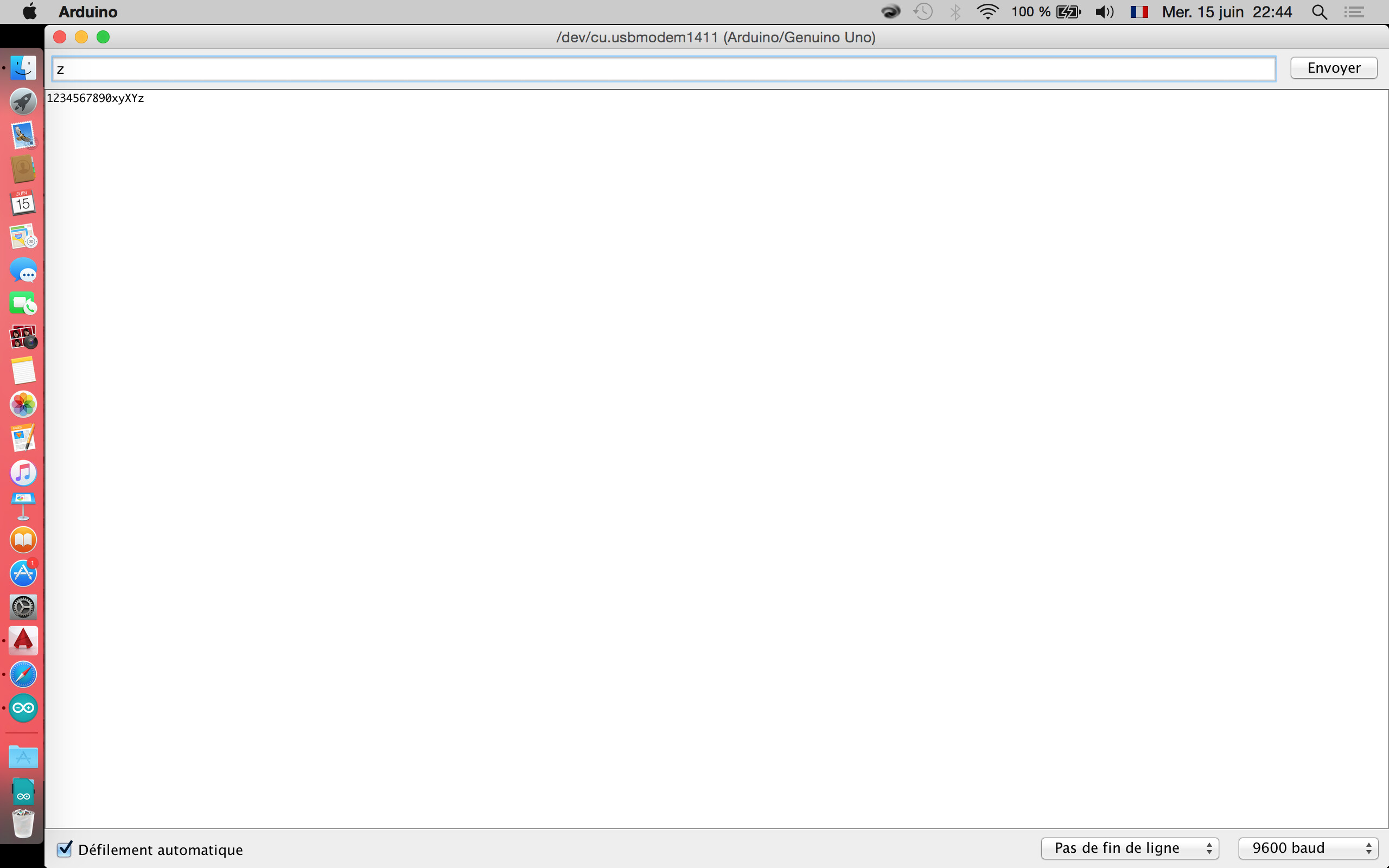

I achieve your 3 steps.
  1. I confirm my L LED blinks 3 times when I open Serial Monitor in the IDE.
  2. I realized the loop back test. Success. My computer hardware driver, my USB cable and my USB to Serial converter work. The communication between my computer and Arduino is present.
  3. I add this preference system.
Now you can see pictures:
-The result of the communication between my computer and Arduino Uno.
Imgur
Now, I received a true "Arduino Uno".
If my hardware driver, USB cable and USB to Serial converter work, where is the problem?

I do not know what this means. Do you have another Arduino that works? Or both do not work?
It is better to copy and paste the text of the error messages rather than pictures, because it is not likely a large number of people would want to or have the ability to copy an http address and paste it manually into an address bar of a browser.
I do not know the solution to this particular problem. You may want to post your question in the International section of the forum if your language is represented there, so there will be people who can read and understand the parts of the error messages that are not in English.
