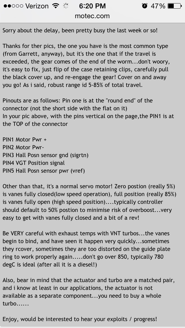

Looking for the capabilities or advise on a setup im trying to do using the Arduino uno. I have a project where I will be using 1 pressure switch analog input, 1 10k pot to vary the pressure switchs input up or down, 1 5 pin servo to control the device im building this for the pin out on the servo is 1 and 2 or power 3 is hall sensor gnd 4 is VGT position signal 5 is hall sensor pos. Now it will have the three inputs pressure sensor, pot, and servo position control, the output im looking for will control a 13A motor control that needs a direction wire, signal wire, and ground. My main question or concern is can the Ardunio uno take in the pressure switch input go to the pot read the servo position and move the motor in a Linear fashion up or down with the pressure switch readings?? I have looked for this with no luck even though I'm sure it is somewhere any help will be appreciated!

The picture is the only info I actually can find on the servo.
That's not a "traditional" servo.
It might take some experimentation to figure-out how it works (voltages, etc.). Since it appears to be automotive, I assume it runs off 12V. It will probably require an H-bridge DC motor driver.
And, you'll need to drive it like a regular DC motor (the servo library won't be of any use).
