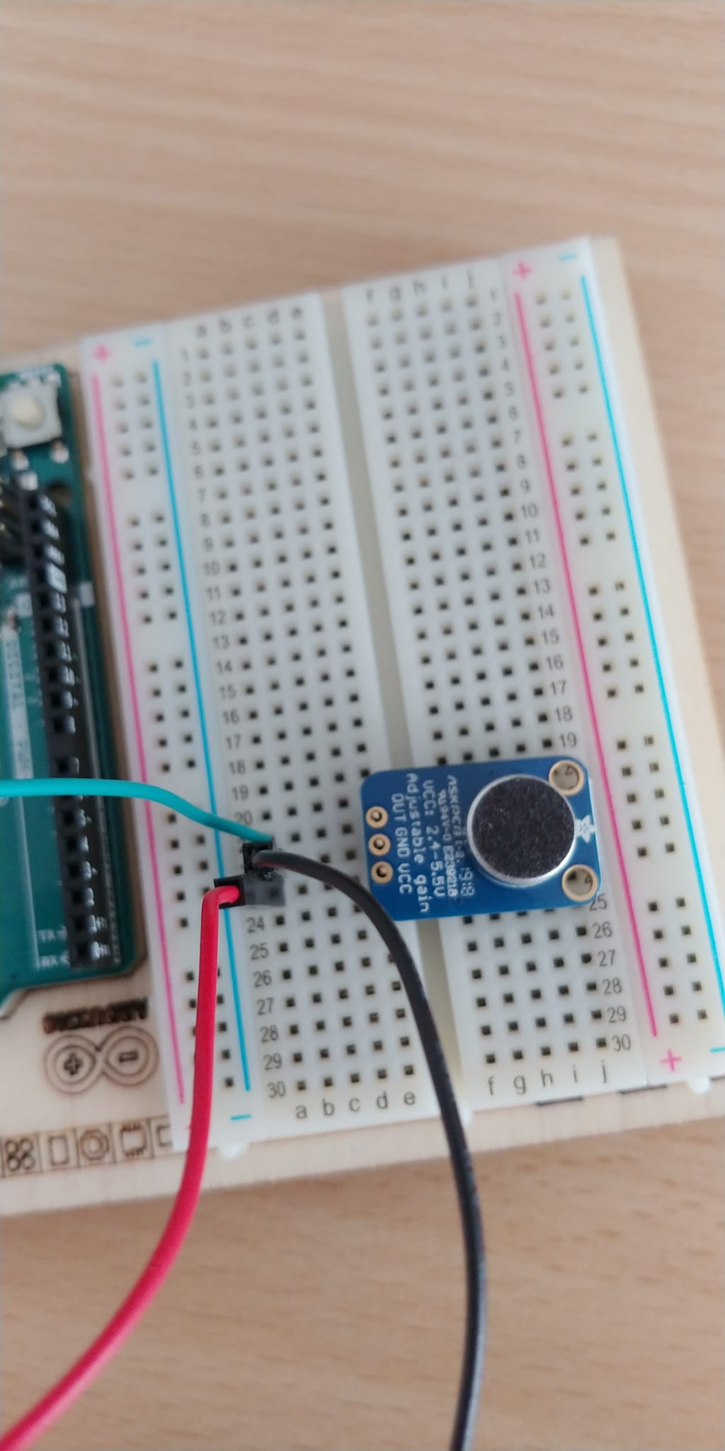

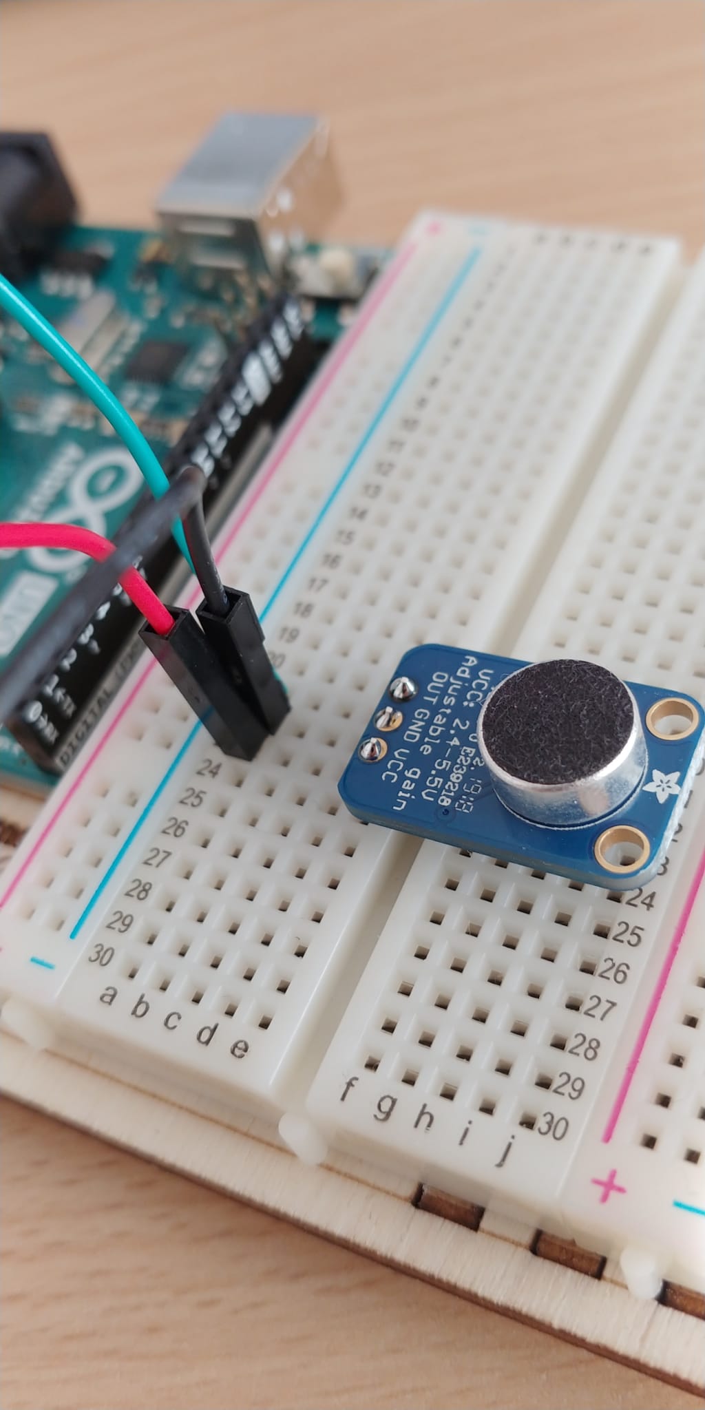

Ok. I've just started with Arduino and I have bought the Adafruit Max4466 Microphone with Adjustable Gain.

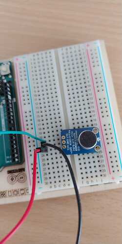

It obviously has three holes for OUTPUT, GND and VCC(Power). Since I dont have a soldering iron yet, I wanted to know if i can just test the microphone with the breadboard and three loose pins stuck into the holes (see picture).
This is obviously a loose connection and I wanted to know if that can damage any of the electronics, or if I will just get some faulty values.
Thanks in advance
It probably will not damage anything but your sanity trying to get it to work.
Now get out, get to your local hardware shop, and get yourself a soldering iron. 25-40W will do fine, temperature controlled and all is of course best.
You are not likely to damage anything but you will not get reliable results, if any
Imagine if the question were "the nut holding on my car steering wheel is loose, will it affect my ability to drive it ?"
For a three pin connection it will work if you wedge something rubbery under the microphone module such as to make it twist upwards and hold contact with the header pins.
Your question is the opposite - every so often we try and assist someone with an extremely puzzling problem until a photograph reveals they are trying to use a 28 pin module sitting on pin headers on a breadboard and most are as you would expect, making no connection. In your case with three pins, it generally will work if you apply consistent pressure. :grinning:
