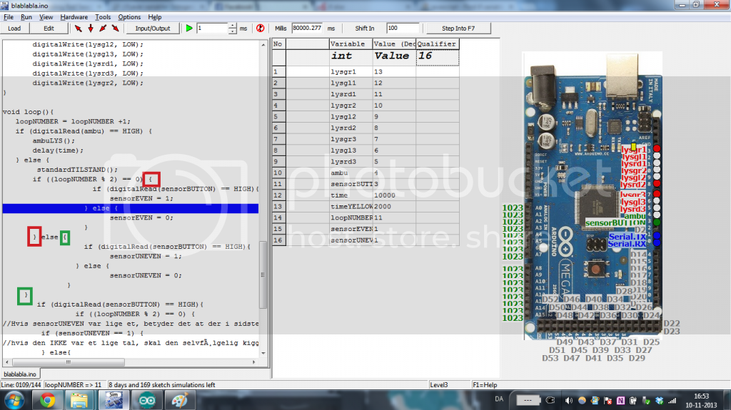

I was just thinking.. Since i only need to keep record of the current and previous loop, could i then do it by changing the variable sensor2 in the case where the loop-number (loopTal) is even, and create another variable that is changed when the loop-number is uneven. Like this:
       if (loopTal % 2) == 0) {
         if (digitalRead(knap1) == HIGH){
         sensor2 = 1;
         sensor2 = 0;
         sensor1 = 1;
         sensor1 = 0;
The loopTal-value will change even to uneven infintely, so maybe i can do something like - "If loopTal is even, then take the sensor2 value - but if its uneven, take the sensor1 value". Does that make sense?
I haven't bothered looking into the context for that code, but given that you have two sensor variables and want to decide which one to access based on another variable, holding those variables in an array seems like the most obvious approach.
If you're looking for compactness, you could perform the whole thing in a single statement.
sensor[loopTal % 2] = (digitalRead(knap1) == HIGH);
Yes, and that should work.
You could also use a global or static array, of size 2, and use loopTal as an index into the array, to define where to store the new value and where to read the value from.
I would love to the array thing, but i simply dont know how to approach it.. Anyways i gave the other thing a try: I removed leftovers and changed the variablenames to english:

It was very confusing writing and understanding that.. But does it make sense? Sadly i don't have the board with me, so i can't test it yet. :frowning:
       digitalWrite(lysrd1 && lysrd2 && lysrd3, HIGH);
What do you think this is doing? I don't see the value in setting pin 0 or pin 1 HIGH, which is what this code is ACTUALLY doing.
PaulS:
lysrd1, lysrd2 and lysrd3 are connected to pin 5, 8 and 11 in the top. So the line is supposed to turn those 3 pins to HIGH. Is that wrong?
They're all non-zero, so it's just the same as writing digitalWrite(1, HIGH);
Unless you've checked the box on the IDE that's labeled "Let me invent shortcuts", yes it is.
Seeing as how there is no such checkbox, you can't invent shortcuts. There is A function for turning A pin on or off. If you want to turn two or three pins on or off, you can create a new function that turns more than one pin on or off, or you can call the one existing function multiple times.
PaulS:
Ah ok, so this would be the correct way unless i do the function?:
       digitalWrite(lysrd1, HIGH);
       digitalWrite(lysrd2, HIGH);
       digitalWrite(lysrd3, HIGH);
SUCCES! I cleaned the whole thing up and cleared the mistakes as you mentioned and it compiled with no further errors! Some brackets and ()'s and it compiled perfectly. I tried it in a simulator, and it seems to run smooth.
Thanks for your guidance! Ill come back if it turns out to not work with the whole thing wired up, hehe :slight_smile:

It seems another issue came up.
The if-statement that asks if the loopNUMBER is an even number, is doing something weird. As you can see in the image, in the middle - loopNUMBER is in this specific case set to 11 (an un-even number).
The red boxes/brackets are for if the if-statement is true, meaning loopNUMBER is an even number - and the green boxes/brackets are what happens if loopNUMBER is an uneven number. The blue-line explains where i step by step am in the loop - but since the loopNUMBER value is uneven, why does it jump to the else-statement inside the outer if-statement, when it's supposed to jump to the outer else-statement? Does my question make sense? :smiley:
Does it have anything to do with how my lines are spaced, organized - that the program may read it differently than i want i to?
Thanks in advance. :slight_smile:
I don't know what emulator you are using, but I would have thought that the red boxes would have signified a failed test and the green ones a successful test. That makes more sense to me. Red = warning, green = OK. Are you sure that you are describing the meaning of the colours correctly ?
What value do you get if you set a variable to (loopNUMBER % 2) or print it before testing it ? Does the emulator handle the modulo operator correctly ?
UKHeliBob:
The green/red boxes are made in paint by myself, not by the emulator, hehe.
Can i do what you're suggesting by defining: int k = {(loopNUMBER % 2)} in the top, and then just insert k in the if-statement and print k afterwards?
I tried that, and it prints k = 0 over and over. Meaning it will always be a true if-statement. Very good job there.. But that must mean that the ((loopNUMBER % 2) == 0) doesn't do what it's supposed to. Does anyone have a more specific explanation on the 'variable % 2'? Doesn't it mean - if variable is dividable by 2 or something? It's supposed to tell whether its an even or uneven number.. Any alternatives?
variable & 1
will tell you if the number is odd or even.
