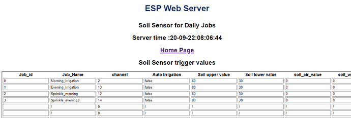

I am trying to build webserver using nodemcu 12e and used AsyncWebServerRequest for building dynamic html page. it is working fine, when i access first time. later if i refresh multiple times, it loading garbage page intermittently.
Actual page
Error page

may be too many Strings and you run short in memory?
what's daily_jobs_arry_size and daily_job_list ?
Don't post snippets (Snippets R Us!)
