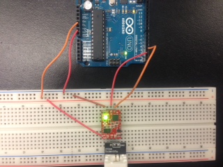

Hi, I am using an Arduino Uno and a Atlas pH sensor, and an Atlas pH circuit to detect the pH of a solution.
I'm not very good at programming and thought that the available code to me would work. I was hoping someone could guide me or at the very least show me the direction I should take. I'm not 100% sure that the Arduino is connecting to the EZO circuit. The code that I have used is the following.I have not received any error messages, but I do not get any output values.
On that note, I was hoping to have the code tell me the exact pH value given a solution. If someone could help me out I would be grateful.

A circuit even hand drawn an photographed would help, as would a description of what actually happens.

The default baud is 38400 but the demo code uses 9600. I suggest changing the baud of serial line connecting to the sensor.
You should be able to type "R" and Enter to trigger the device to send you a reading.
There's wiring information in one of the links from the SparkFun product page.

Here is a photo of the EZO pH circuit connected to the Arduino

As mentioned above, the sample sketch does not use the default baud. I suspect this is the main reason DiegoALR wasn't able to communicate with the sensor.
