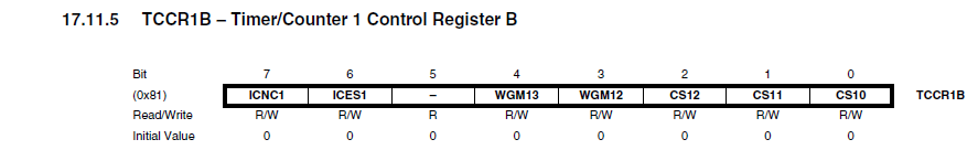

I'm not the specialist regarding hardware timers but below is my view regarding T1. T1 is the external clock source for time/counter 1; see the datasheet. Timer/counter 1 is configured by the Arduino core and does not use the external clock source (unless your code has modified it).

I guess you missed what I tried to say. T1 is the external clock source for time/counter1 and is not used. Timer/counter1 is used, but with an internal clock source.
Ah, I had not understood that correctly,
So in reality I can use the pin without affecting timer 1 as long as timer 1 is using the internal clock source? That is good to know, thanks
From the datasheet
The below program will show you the configuration for timer/counter1

It will show the clock select bits as set by the Arduino core; match it with the table in the second screenshot above.
