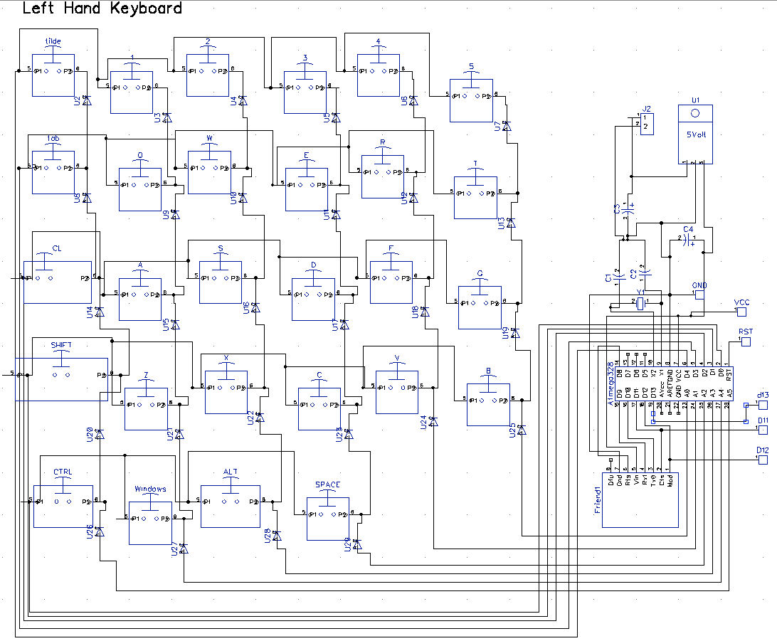

Hi Folks. I have an issue where I’m trying to read some digital pins and their voltages aren’t quite low enough. I’m looking for suggestions.
Here’s the story:
I’ve built a split keyboard so I’ll just describe one of them but both behave the same.
I had a PCB manufactured. It uses an Atmega328. Pins 0 through 4 are set as outputs and set high. They are my rows. And I’m not using pin 0 to receive anything so I believe this is okay.
I’m using analog pins 0 through 5 as digital inputs with the internal pull up set. These are the columns.
I have an outer loop that sequentially sets each row to low. I have a nested loop that runs through each column then tries a digitalRead on the corresponding pin. If it’s LOW, then I know that the key at the corresponding row and column has been pressed.
Now all of this works great for most of the keys except those furthest from the MCU. When I probe these with an oscilloscope, I can see a nice square wave with the voltage drop to a bit above 3V. The other keys, the ones that work, drop a bit further - just below 3V which is evidently enough to be read as LOW.
If I do an analogRead rather than digitalRead, and check if the value is less than 900, all the keys work but it all becomes too slow after I add logic to handle modifier keys (shift, ctrl, etc.).
I wonder if the diodes by each key may have too high a resistance - preventing the pins from dropping low fast enough. The diodes are 1N4148s. They are there to prevent ghosting.
I’ve also fiddled with setting the output pins’ bits directly to speed things up (rather than use the digitalWrite) but haven’t figured out how to do a similarly fast read of the analog pins.

Post schematic. Why is the voltage not dropping to near zero?
" The other keys, the ones that work, drop a bit further - just below 3V which is evidently enough to be read as LOW."
Reading a LOW output from another pin should be much lower - <1.5V. Unless there is too much pullup resistance and the pin can’t sink enough current.

I’ve attached a screenshot of one of the keyboards. The rows are those wires going over the top of the keys. The columns are those attached to the diodes.

Hi Crossroads,
These diodes are reading about 0.592 Ohms on my multi-meter. And the keys furthest away from the MCU are going through 5 of them. That’s about 3 Ohms total. It sounds like this is my problem, no? If so, what to do about it?
Is there a better diode than the 1N4148 - which is the one I’ve read as being recommended because it’s “fast”.
I don't think your button/diode design is correct then. I gotta run, I'll try and look at that later tonight.
Oh! There's your problem. The diodes are wired wrong - you're getting caught by the 0.7v drop across each diode.
You shouldn't have the signal going through more than one diode, ever. The column line should be connected directly to each of the 5 diodes, instead of being chained like you have them.
Time for a respin (or some patient work with a razor blade and soldering iron on your prototype)
Yup. I screwed it up alright - put those diodes in series. I think I can fix it.
