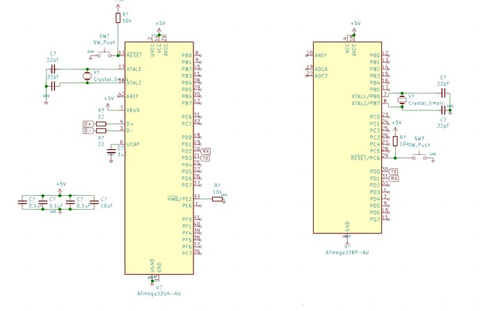

This is the basic "barebones" for each microcontroller. The I2c pins on the 328P will be used for a display, and the rest of the pins will be used to control lights. on the 32u4, the pins will be used to receive keyboard inputs and rotary encoder inputs. They are connected via UART to talk to each other and sync the lights to the keystrokes.
Would the UART connection Interfere with the programming of the 328P?
So the bootloader hasn't been burned yet, right?
In that case you need to program with ICSP first.
A corresponding programmer is required to program the bootloader using ICSP from the Arduino IDE.
Do you have anything?
You can also use another Arduino.

There is no problem because ICSP is done by SPI.
But, after programming the bootloader, it can be a problem when if you upload sketches via the bootloader using USB-UART.
I don't have any parts yet. As I said, I am still just planning out ideas. The microcontrollers will be soldered onto a custom PCB. The spi pins will be used by a matrix. so could I use an FTDI programmer with the 328p?
I should say that I think I could put the breadboard version of the 328p into my PCB, what way I could use another arduino to program it
There is a way to ICSP using FTDI, but Arduino IDE doesn't support it.
The bootloader must already be programmed to program using the UART like a normal Arduino.
So all blank 328P the first program needs ICSP.

That would work, I could also use a breadboard 328P instead.
Yeah, give it a try.
And create topic again if you have any problems at program 328P.
