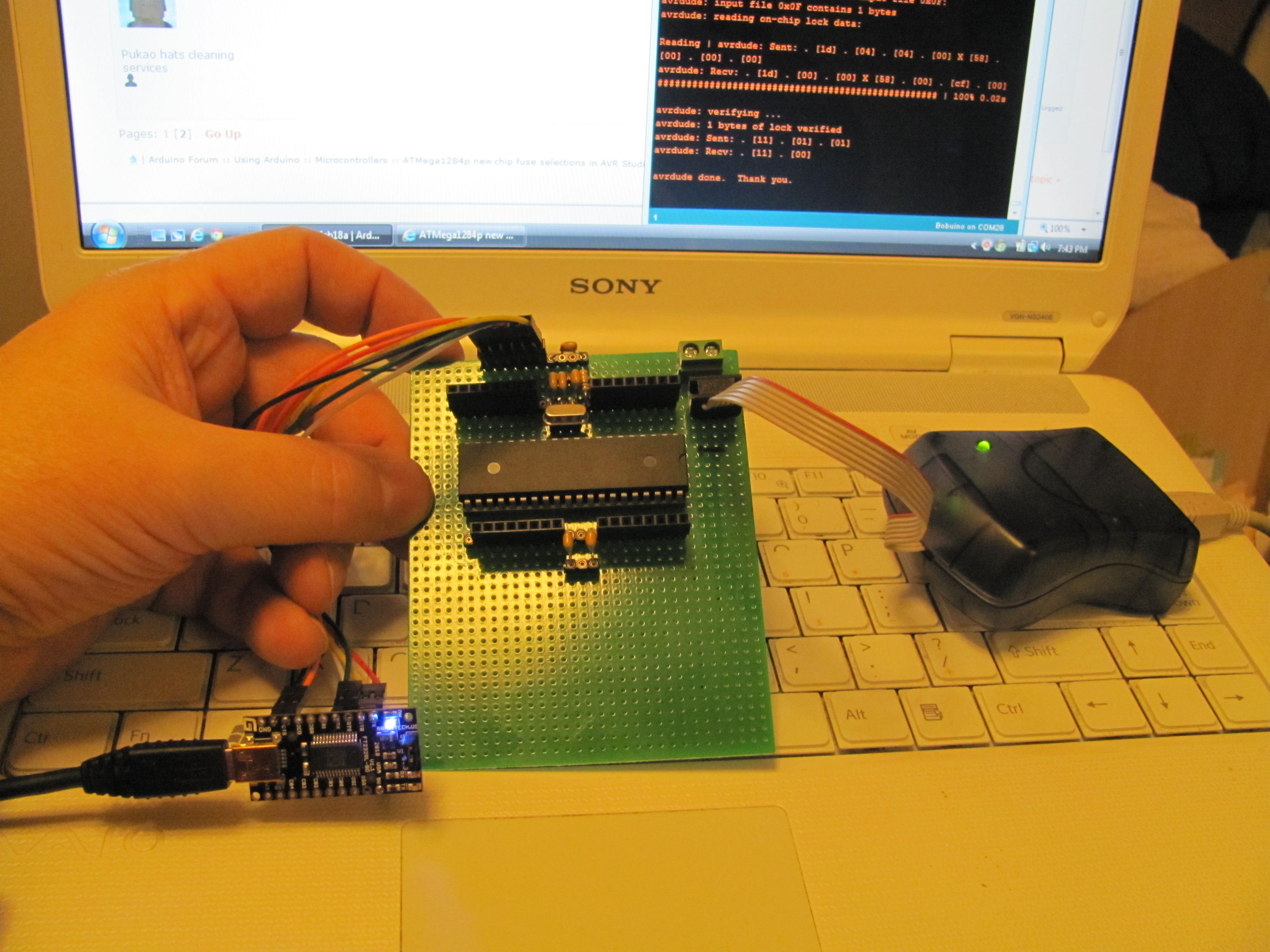

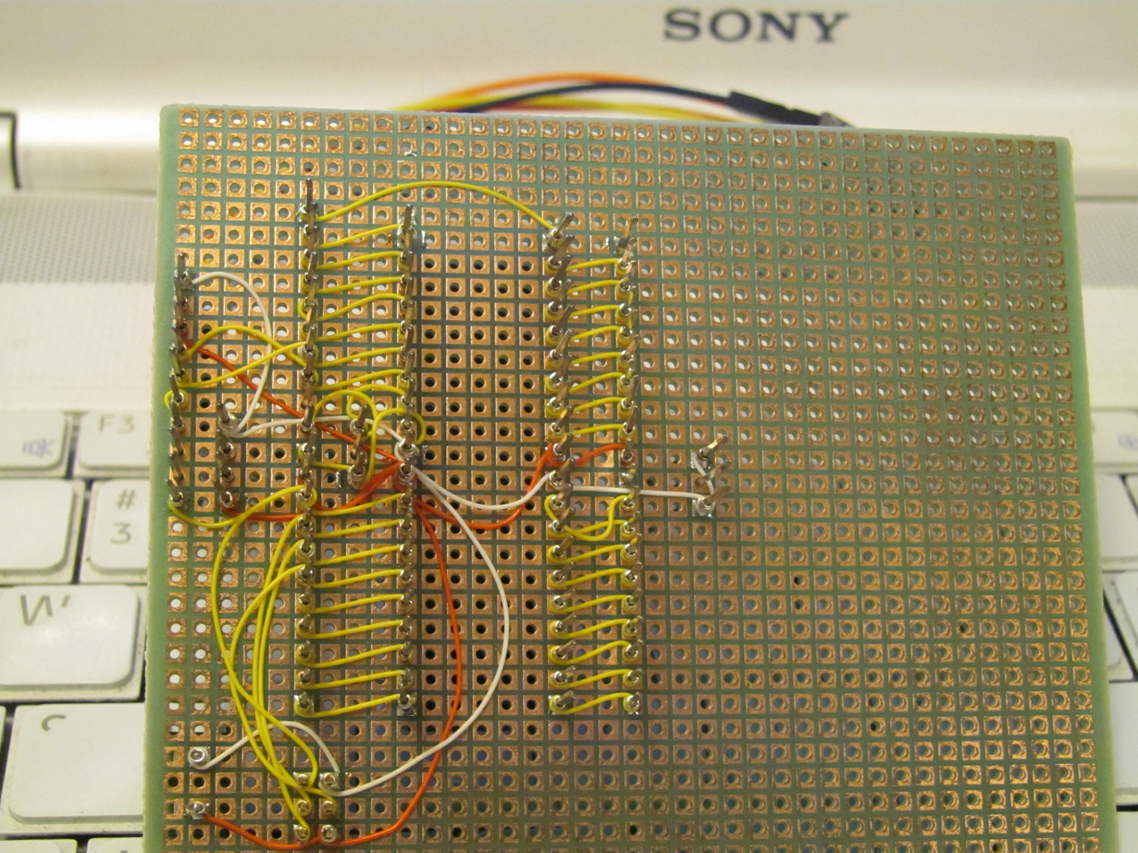

Right, so I can take this simple "island of holes" board, wirewrap it up, bring in power via an FTDI module, bootload it via an AVR ISP MKii, then download a sketch via the FTDI module, and I'm the only one in the whole forum able to get this to work?
Chip is date coded 1050.
Here's my 1284 board files and the entry from boards.txt. Maybe there's something different about my bootloader file?
optiboot_atmega1284p.hex (1.47 KB)
pins_arduino.h (6.21 KB)
