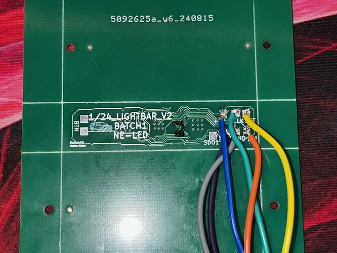

I'm having issues with my Atmega328p-MU. It seems as if the Atmega keeps resetting, freezing, and sending out garbage data. I have it pared with two TLC5947 (QFN) Shift Registers.
I'm sure it's the Atmega because the way that I designed the board was to be able to bypass the Atmega to trouble shoot. When using the bypass, the shift registers work correctly.
Not working correctly when using onboard Atmega328P-MU
Sporadic
Working with Bypass
Normal

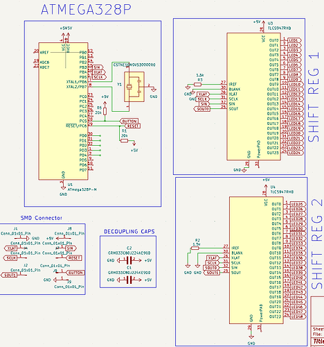

Schematic

  • Two de-coupling capacitors just doesn’t cut it.
    You need one capacitor per Vcc/Vdd pin per I.C., mounted very close to the power pin.
Edit

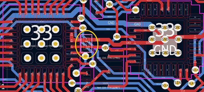

Thanks For your reply.
The only cap that I have on-hand is a .47uF Electrolytic. I soldered this to the 5VDC and GND pads on the rear of the PCB. And it worked!
Now my question is:
  1. Should I just use another .22 pF Ceramic cap (GRM033C80J224KE90D) across VDC and GND of the atmega?
  2. Put a larger Decoupling cap across the pads on the rear?
  3. Or should I do both?
One last thing was that I was trying to use the same .22pF ceramic cap to decouple one of the TLC5947's and the atmega. Is this a bad practice?
Here is a screenshot of what I mean:
  • I hope you mean 220nF ceramic (a common value is 100nF)
  • Suggest you add 100nF on each Vdd pin.
  • It appears there is no GND plane, next version should be multi layer with an unbroken GND plane.
  • 22uF ceramic bulk capacitor(s) are also needed.
Edit
  • In the future, do not run signal traces under crystals.
