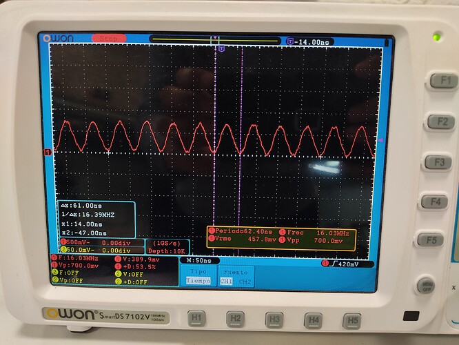

Hi. I'm trying to program a single ATMEGA328PB MCU using MiniCore and a USBTinyISP programmer.
At this time, i can burn the bootloader and upload any sketch using the 8 MHz internal oscillator, but when I try to program using the "External 16 MHz" option, the process is not done succesfully. I have a lot of 50 ATMEGA328PB pieces and all of them show the same behaviour.
The circuit I'm using consists in one 16 MHz crystal and 2x 22pF capacitors as shown in the image.
The error message I get when i try to burn the bootloader using the External 16 MHz option is shown below:

avrdude: verification error, first mismatch at byte 0x7e00
0x08 != 0x01
avrdude: verification error; content mismatch
avrdude done. Thank you.
Error quemando bootloader
