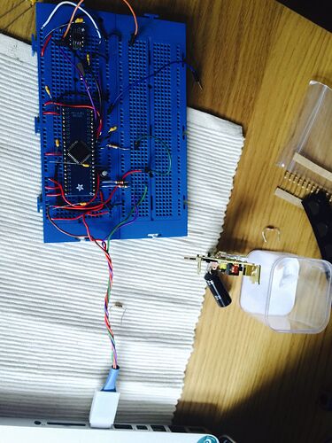

The first image is my first setup(the blue breadboard) i added lots of decoupling capacitors
The Second image is of my next setup (white board) is the one where i ensured all of the connections are good. I tried a larger 330uF capacitor and it works well for my mac. But not for my windows PC.
If anyone cant see the image clearly, i have 3 black capacitors , one for UCap, one for reset to GND ( i followed a tutorial on how to prevent auto reset on the website) and the one on the rails is my test decoupling capacitor.
From my experiences with bread boards, theres always some parasitic capacitance so i tried removing it with a large capacitor , it might not be the solution , this is just for testing.
again, i based my layout on
http://murchlabs.com/monday-experiment-bootloading-an-atmega32u4-with-arduino/
with the modification of the UVCC on pin 7 connected to VCC and the capacitor on Reset.
Btw, if you are wondering why dont i have pullup resistors on the I2C rails, its because with it, i dont get any results on the serial monitor. On the oscilloscope, the pulses are significantly lower in amplitude . I have read up on proper values of the pullup resistor for both SDA and SCl lines and i have used resistors ranging from 100R all the way to 10K and the best results is that without the resistors.
The decoupling capacitor for the oscillator is 22pF as recommended
Ucap is 1uF
and the one from reset to GND is 10uF
i have also tried the setup where there is a pullup resistor from reset to VCC. Same results.
Thank you all again so much for your time.
Hello again, i bring updates. So i added a trimmer pot to the SCL line and tuned it until i get something. and it started working on my windows without the presence of the oscilloscope . So i took out the trimmer pot, measure the resistance , and it came out as 132 R. i am still trying to find a resistor combination that suits this, but it appears to be my pullup resistor values has to be in some specific range to work.
Has anyone faced this problem before?
You must have a pretty hefty capacitive load on the SCL line if you need 132 ohm to pull it from low to high. 4.7K for 5V and 3.3K for 3.3V are usually plenty.
With 132 ohm, that's 25mA to bring the line low if pulled to 3.3V
And 38mA for 5V?
Doesn't sound to me that things are wired correctly.

The crystal should not connect via wires, but directly to the pins.
The 22pF should be as close as possible to the crystal and to a GND pin of the ATmega32U4.
I see a Adafruit logo on that pcb, but I can't find that breakout board at Adafruit.com
You need a good oscilloscope to see what is going on.
What about the power ? Is it too high or too low, or very noisy ?
With all your tests, what was the same all the time ?
I stick to my advice : Buy an Arduino Leonardo board, and make that work. If that works well, you can try to copy it to this. You might have damaged the I2C chip, or the ATmega32U4 chip. The ATmega32U4 can be damaged for only a part while other parts inside the ATmega32U4 still work. If you are really stuck, start all over again.

edit: i have tested with an I2C display and it works perfectly, No lags, no noise, like how it would work on a normal arduino, and the thing that fixed it is the 132 ohm resistor?
what peter said could be right, that i have damaged the I2C chip internally and have somehow manage to find a Resistance that hits the sweet spot of the line. Its all just my theory anyway.
