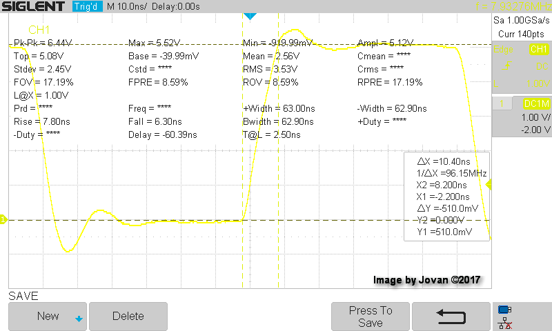

Hi all, after many turns of code optimization for Pin_xx (usually D13) on Arduino UNO and Leonardo boards with 8-bit ATmega328p/32u4 Micro-controllers (MCU's) I come up with something interesting.
So far we all consider empty-endless While(1){...} and For(;;){...} loops to be fastest C/C++ structures that will ensure us minimal possible delays in bit banging of the I/O ports. Unfortunately they consume more then 2T cycles and structure like this:
noInterrupts();
for(;;){
PORTB = B00100000;
PORTB = B11011110;
Will give us Port B5 eg. Arduino Uno PIN13 signal with frequency less then 4MHz and with distinctive peak on after 2nd PORTB command.
By taking brute force we can make sequence of tens or hundreds repetitions of just assigning bit register values like this:
noInterrupts();
for(;;){
PORTB = B00100000;
PORTB = B11011110;
PORTB = B00100000;
PORTB = B11011110;
PORTB = B00100000;
PORTB = B11011110;
PORTB = B00100000;
It will render signal pattern with glitch after last line but it will reach theoretical limits of MCU's (almost as Assembler code will do) and produce Bit-banging signal of almost 1/2 F(cloock) or in Arduino Uno/Leonardo case ~ 8 MHz.
Check attached images >
Question is can we optimize loop code to make faster transition between end and start?
