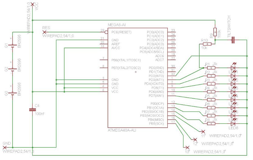

I have found that if PD2 is at 0V everything is OK, if set to 4.1V all the LEDs flicker (are on but at low and different brightnesses) and the program restarts once PD2 drops back to 0V.

If you can, swap the 100K resistor (the one parallel to the tilt switch) with a 10K resistor. The voltage at PD2 should be 1/2 VCC. Is it?
Well nearly, it's a bit higher than predicted by a simple R2/(R1+R2). The 10k is really 10.02k and the one I swapped for the 100k is 9.91k but the voltage on PD2 is 0.53Vcc so that works out at the equivalent of 71.5k inside the microprocessor between PD2 and the supply. Is that about right for pinMode INPUT?

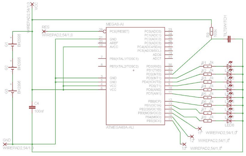

I have increased all the resistors now as per the following non-working circuit:
and this circuit which works fine (have to change PD3 to input before setting interrupt and then to output as soon as it wakes.
Not a EE type but I don't see why you have those 3 capacitors in series in your schematic.
LOL, those are the symbols for three series battery cells powering the whole circuit. Note the unequal length of the two horizontal lines for each cell. Cap symbols use lines of equal length.

To be fair I have mangled some components from the Eagle library with a use-able footprint i.e. capacitor for tiltswitch!
