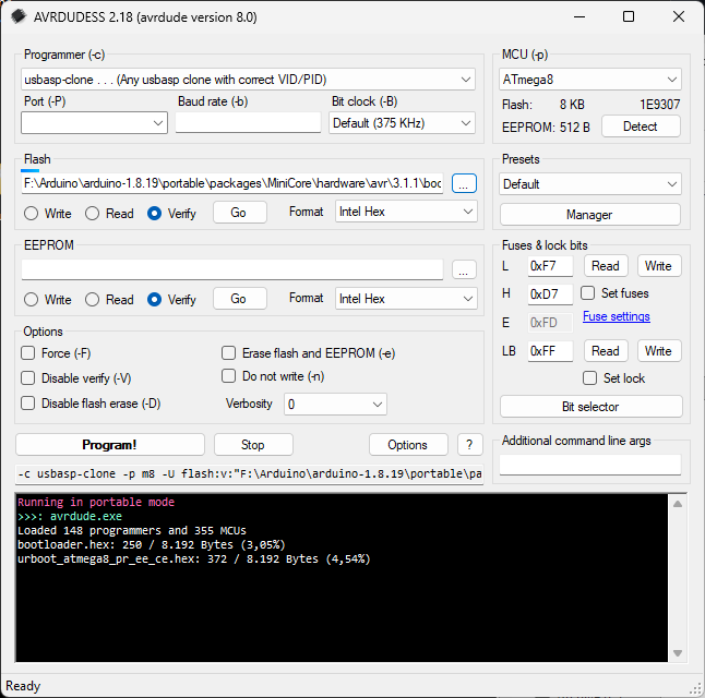

You are right. Minicore selects the bigger bootloader, which is 372 bytes according Avrdude.
 ![image](https://europe1.discourse-cdn.com/arduino/original/4X/5/4/c/54c43af4df013160397bf31dd46fd0db234810fd.png)
Maybe OP [ask Stefan Rueger](https://github.com/stefanrueger/urboot/discussions), who wrote urboot.

@hmeijdam thanks for pointing me to avrdudess, another tool under the belt !
@b707 i checked the HEX file itself, it definitely holds 372 bytes of real information (outside of adresses, record type and checksomes) … so whatever that information is, it’s there.
@hmeijdam I found the related readme along the minicore urboot hex files (i didn't see it at first) at [MiniCore/avr/bootloaders/urboot/atmega8/watchdog\_1\_s/autobaud/uart0\_rxd0\_txd1/led+b5 at master · MCUdude/MiniCore · GitHub](https://github.com/MCUdude/MiniCore/tree/master/avr/bootloaders/urboot/atmega8/watchdog_1_s/autobaud/uart0_rxd0_txd1/led%2Bb5) .
And according to this statement " **Size:** Bootloader code size _including small table at top end_" ... so the extra bytes ought to be something like the `Interrupt Vector table` at table 12-1 and later in the datasheet.
So burning a bootloader might burn a table of the vectors too !
If so, that would make sense, size-wise :
- the bootloader (and only itself) is burnt in the BOOTSZ-size boot area
  - and if sized as shown by avrdudess capture, it would fits in 256 byte (BOOTSZ=0b11)
- the vector table (in the hex file) would be at 0x000 (outside BOOTSZ) (see Table 12-2)
  - its content and size is still to be determined … but that is of lesser importance 🙂
So… i think that rounds it up. Even if it worked perfectly, i could not guess what explained the difference, and now i have a hint. I’ll still browse/ask urboot author page, good advice !
Thanks again, and have a nice day
