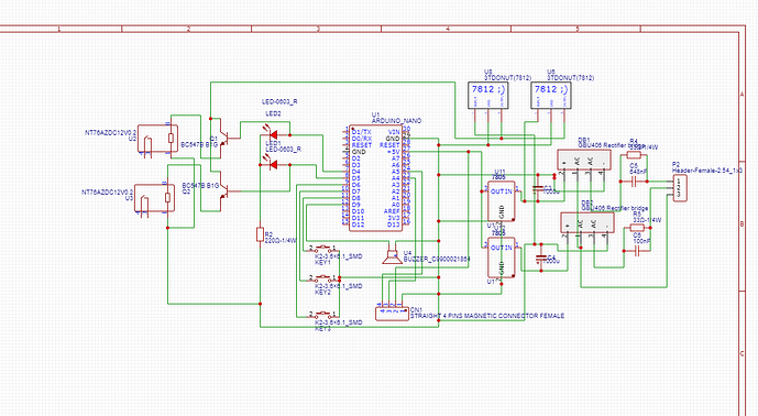

Hello,
I'm working on an ATS with two sources: Main and Gen, using a Nano board. I have created the code as shown below, but I'm facing an issue with the priority between Main and Gen. Specifically, when Main goes offline, the ATS should switch to Gen after a delay of 5 seconds. However, when Main is offline and Gen is running, the ATS switches back to Main after a delay. I have tried to identify the issue in the code but couldn't find the problem. I would like to update the code to meet this condition. |
Condition Action
Main HIGH, Gen High
Main HIGH, Gen OFF|Wait MainDelay → switch to Main
Wait MainDelay → switch to Main|
|Main LOW, Gen HIGH|Wait GenDelay → switch to Generator, no switch to main if its LOW|
|Gen ON, Main returns|Immediately OFF Gen → Wait MainDelay → switch to Main|
I’m writing to seek your support and advice. and thanks to anyone help me.

No clue what we’re discussing here ATS can refer to a lot of different things, from a vehicle to a small module, not to mention various software platforms. Since it looks like you're switching something based on sensor input, we really need an annotated schematic showing exactly how everything is wired. Please include all power sources, ground connections, and clearly note any wires longer than 10 inches (25 cm), as wire length can affect performance and signal integrity.
Hello gilshultz, Thank you for your reply and feedback. The ATS (Automatic Transfer Switch) is used to transfer power between two or more sources, such as the main supply and a generator. Attached is a simple schematic for the circuit I designed.

Your project sounds plausible but there is a lot that needs to be considered that I do not see.
How will this be packaged, in a grounded metal enclosure?
It appears this will be mains voltage, what happens if both relays energize at the same time. You need to interlock them so this does not happen. Processors can mess up when getting transients.
If you reverse bias a 7805 voltage regulator, it can be damaged because the output voltage may exceed the input voltage, causing current to flow in the wrong direction. This is possible as the two outputs are connected and if an input fails? To prevent this, a diode is often placed across the regulator to safely redirect any reverse current.
You will probably need more then 5 seconds for the generator to stabilize. I suggest about 30 seconds. Then before going back to the mains be sure they are stable for at least 30 seconds.
You are missing bulk capacitors on the 5V and and high frequency bypass capacitors on both in and out of the 7805. If left as is it will probably sound like a buzzer. I would spend the extra penny and add another resistor so each LED has one as it is possible they both could be on.
What are you using for a watch dog?
