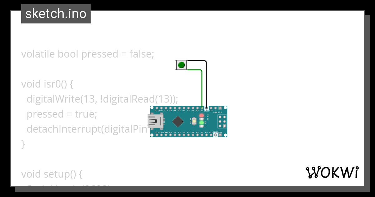

attachInterrupt/detachInterrupt crash
I thought I remember reading about this before, but I am having a crash on the GIGA
using attachInterrupt, followed by detachInterrupt and maybe it is when I then later try to reattach the interrupt.
My quick search in this forum, I did not find any hits, but I probably missed it.
The following code is a quick and dirty extract from some other code (SoftwareSerial),
that I am playing with which crashes.

Note If I comment out the detachInterrupt it does not crash...
My current hookup has a jumper wire between pins 1 and 2, and it crashes when
I enter something into serial monitor. I commented out the simulated restart (2nd attach) as I thought it was the thing that was faulting.
The idea is. With the RX code for SoftwareSerial I am playing with. Is that we set an ISR
on the RX Pin, that when it receives the Start bit, the ISR is triggered, it turns off that ISR, and turns on a Timer Interrupt, where at each of these interrupts is samples the RX pin. When it receives the stop bit, it turns off the timer and turns back the pin interrupt.

IF you detach an interrupt inside the interrupt, you destroy the ability of the interrupt code to return to the instruction following the interrupt taking place.
