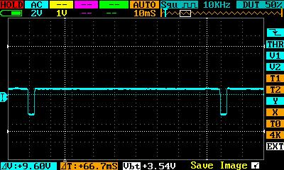

I'm trying to read RPMs off the flywheel magnet of a Briggs and Stratton engine using a VR sensor. The problem is the magnet is really strong and I get some really high voltage readings (just turning engine over with the starter looks to be about 45 volts peak to peak) from the sensor and from what I can figure the voltage only increases as the RPMs increase. I need a circuit that can attenuate this signal and turn it into a square wave so my Arduino can read it but I'm not sure how to go about doing it. I'm pretty sure I'll need a Schmitt Trigger but I know it cant handle that kind of voltage. Any help is appreciated.
Here is an oscilloscope reading of the signal...

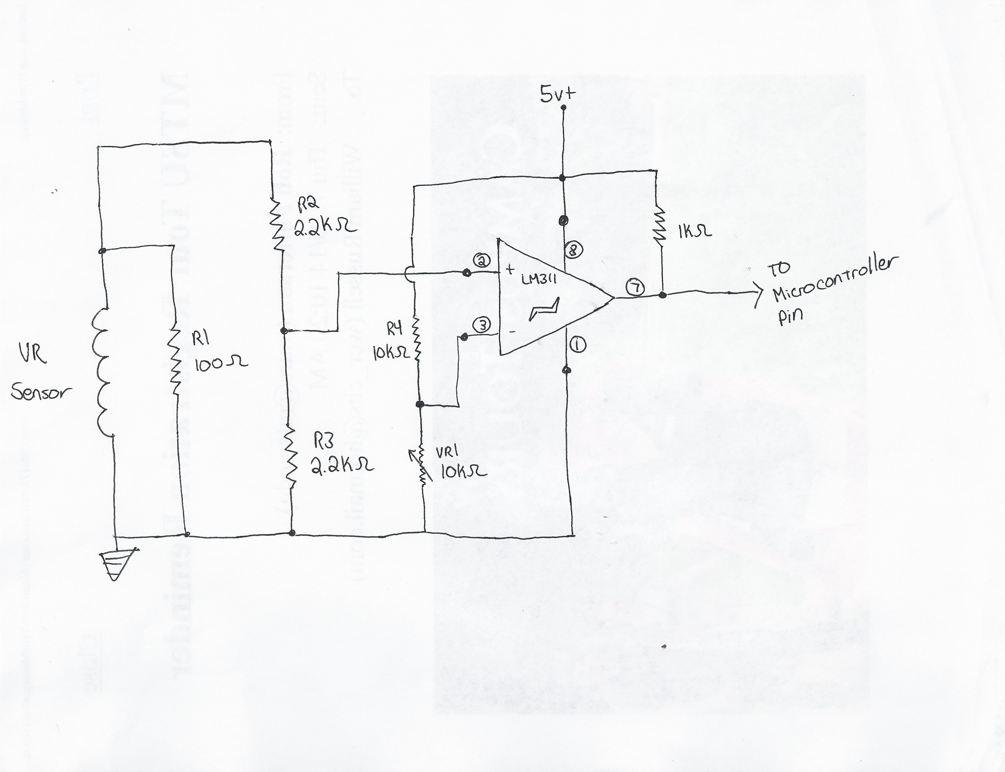

Ok so I came up with a circuit using a voltage divider and a voltage comparator. It works but I dont know what will happen at higher RPMs. I got a schematic and an oscilloscope reading of the output. Tell me what you guys think cause its something I feel like I just threw together without understanding it all.pi

EDIT: Comment - I haven't used the LM311 comparator, but I see that its differential input voltage range is ±30V ... I would check to see that this is not exceeded on it's input terminals.
what is the magnet polarity? because the voltage from the coil will be AC not DC like a generator output so adding a full wave rectifier bridge before the voltage divider could be a good idea I think.
Or a "clamp diode" anode to the ground and cathode to the operational amplifier input after the voltage divider.
if the voltage from the coil comes negative at the input, under the OP ground you could have "latch up" (i'm searching the good term) problems.
edit: phase reversal is the good term :slight_smile:

Same thing for the V+ supply rail. so perhaps your voltage divider is not sufficient at higher speed (higher voltage) and you have the phase reversal phenomenon.

Your comparator CCT will work just fine and has the advantage of having hysteresis and threshold adjustment.
I agree with that.

Minor point but after you added the signal conditioning circuit you forgot to change the coupling for the scope input from AC to DC.

can you draw the complete schematic diagram? or its always this one:
link
the ground is common to the arduino board?
Just some thought: What would happen if I'm getting a negative voltage on my input pin?
I don't believe this is the issue because a negative voltage of such severity that crashes the Arduino would most surely have destroyed it's input or more. Note that the LM311 is connected in single supply mode with 5V and GND, it has internal I/O protection diodes and so does the Arduino.
I believe as the signal crosses the refrence point, the LM311 could momentarily burst into oscillation (as mentioned in the datasheet). To prevent this, add hysteresis by connecting a feedback resistor of 510K from pin 7 to pin 3 of the LM311.

Reset does not work after it has crashed. The only way I have found to get it to work again is to flash it again. I am using the same schematic and ground is always common between my protoboard and the microcontroller.
dlloyd:
With the code provided, the iteration speed should be well above several kHz, so in terms of monitoring the input, this would represent a max. rpm of above 120,000. Of course this is just meant as a starting point to test the input. In your final solution you may need to use an interrupt. I left the print speed at 9600 to start, but changing it to 115200 would be an improvement.
I didnt have a 510k resistor so I used a 560k instead and I tried your code as well but I still get the same thing.
