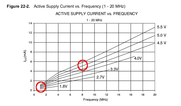

Voltage is directly related to Attiny power draw.

All timers will be stopped when you enter power down mode. They will resume operation from where they were stopped when you entered power down mode.

Anyway, if you have 150mAh 3V battery and power-down sleep current draw is 2uA, it would give ~10 years if self discharge is not considered.

With a Quiescent Current of 4mA your batteries won't last long
If that's not the case at the moment, prefer 3V.
