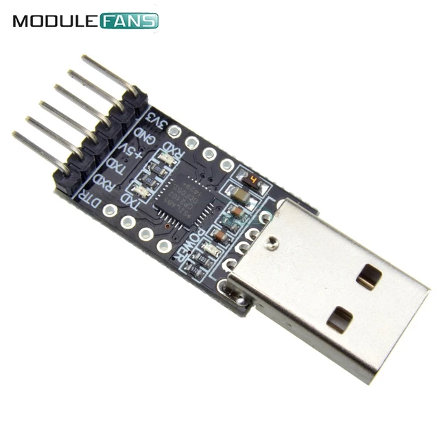

I am using the last version so 1.1.4, the package of the chip is a xu so very very smal on a breadboard adapter like this, the serial to ttl is a cp2102 board like this , the library is this i choosed it in the first place because i needed the smallest possible but really the size of the sketch is not a problem
