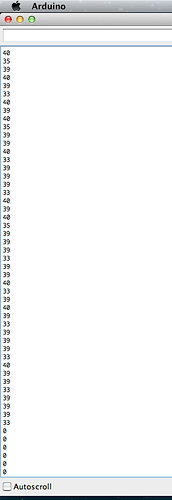

Alright I'm stuck…
What am i missing here?
Using the code i posted in #4 {and every variation i can think of} i am not able to get the return of approx 40micros.
With the 12500 signal absent i am getting a slow vertical string of 1's about every second.
With the signal present, i am getting a very rapid string of 0's
I have fiddled with the code a bunch, but am not able to get results in the serial monitor that i am expecting.
Seems like their is some sort of math or scalar that I'm missing somewhere?

Your reading the pin using pulseIn and doing nothing with the result but then read the pin using digitalRead and print that result.
That much i understand.
I was at one point getting it to print the input pin number at one time, which made me realize i have some sort of syntax error? Or just bad code in general.
So how do i get the return of pulsein to print to the serial window?
I know it seems simple to you guys, but my mind is reeling over here.

When i use that code, i get a slow string of 0's with no signal present, and string of wild numbers when the signal is present.
It seems like pulsein is working, I'm just getting a garbage return. I know its a simple error, but man. I'm having a tough time finding it. heres a screen cap of serial monitor window using the above code.
0's are signal off, crazy numbers are with the square wave running.
I fell asleep on the couch working on this, woke up in the middle of the night worked on it some more. lol. Im going back to bed! Hopefully it will start to make sense in the morning :wink:
The code you have should be doing what you want. The only reason I can think the values vary so much is the pin is floating, the signal is not a clean TTL level or not a constant 50% duty cycle. You could try either a pullup or pulldown resistor on the input pin to see if the results stabilize. Pullup could be done on the chip by using pinMode(pin, INPUT_PULLUP); instead of pinMode(pin, INPUT); but you will maybe need to use LOW in the pulseIn instead of HIGH. For pulldown use the same code you currently have (INPUT) and put a 10K resistor between the input pin and ground.
Ok so right now i am using the code i posted last night {this morning?}
With the charge pump signal running, i am getting a return of 33-40 in the serial monitor window.

This made me wonder what Erni was using to create his 12500hz signal when he got the return of 40-41
I was using my Arduino UNO and the tone library.
tone(7,12500)
An I measured the 40-41 microseconds on an ATtiny85 using a sketch much like the one you are using now.
BTW the values you get now seems OK, as youn only have to decide if there is a signal or not.
