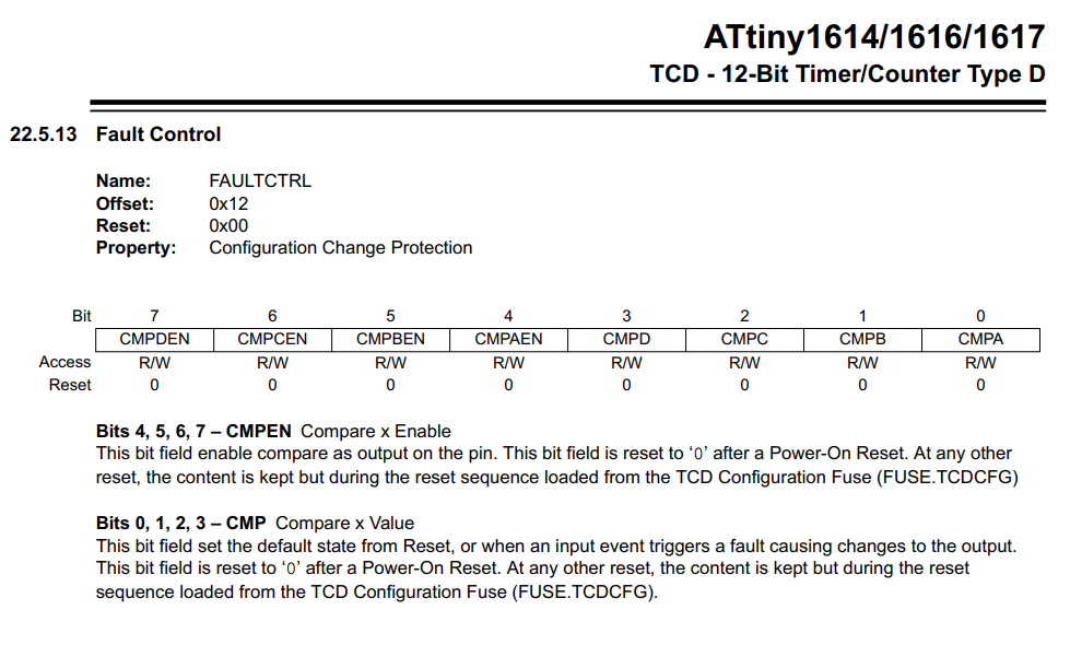

That's done in the TCD0_FAULTCTRL register

//  TCD0_FAULTCTRL |= TCD_CMPAEN_bm;// // enable Waveform Output A (WOA) from TCD0 to PA6
//  TCD0_FAULTCTRL |= TCD_CMPCEN_bm;// // enable Waveform Output C (WOC) from TCD0 to PC0
  TCD0_FAULTCTRL |= TCD_CMPAEN_bm |TCD_CMPCEN_bm;// or on both at the same time
//  TCD0_FAULTCTRL |= TCD_CMPDEN_bm;// // enable Waveform Output D (WOD) from TCD0 to PC1
  TCD0_FAULTCTRL |= TCD_CMPCEN_bm | TCD_CMPDEN_bm; // enable both at the same time

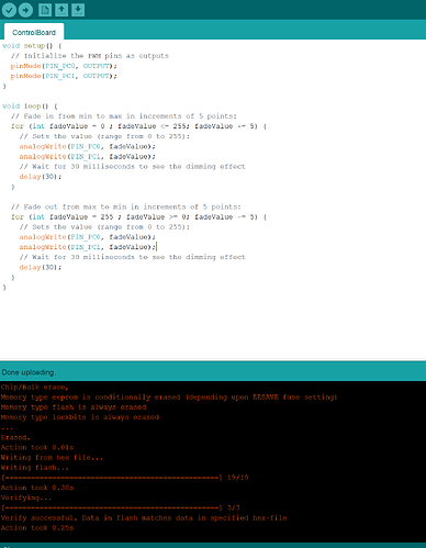

I took your advice and moved over to the Arduino IDE and we're seeing a PWM signal on the two outputs we require. It doesn't appear the manual register configuration is required when using megaTinyCore. megaTinyCore
Yes, I tried that also to check if the PWM mapping worked. You don't even need to set the pins to OUTPUT yourself. Analogwrite will do that for you.
