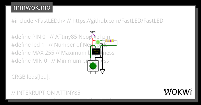

Here are some ATtiny85/WS2812 functions that you can try...
And a few boooring LEDs....
